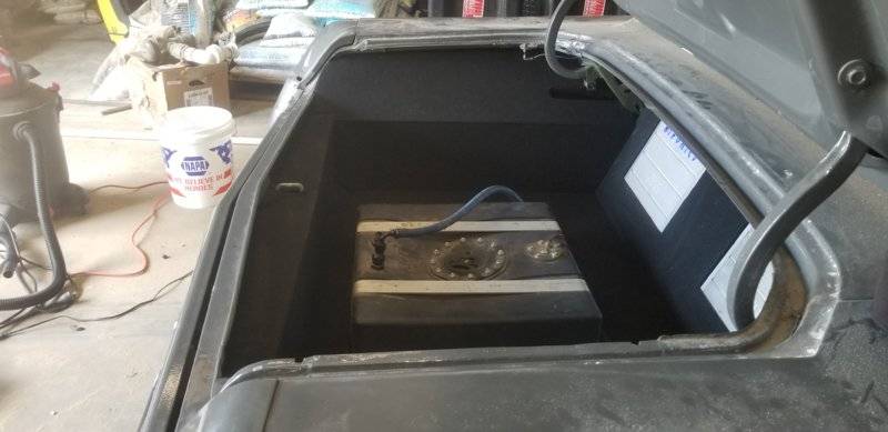

Ok everyone seems to do the trunk strip so I thought I would be different. Here's the newest addition.
but at least now people know its a plymouth and not a dodge
Powder coat isnt a 100% match, but no one makes a destroyer grey color.
