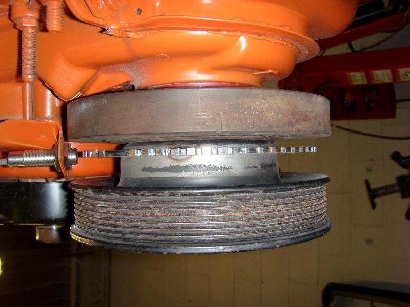

I already posted this once back in May when you asked about it, but here's what I did to mine to run the MS2. Still trouble free.

Yeah I remember that picture. What are you using for your cam signal? Is yours a single coil set up? Batch fire or sequential?
I don't have a steel crank pulley so I will be mounting a ringed wheel like yours to an aluminum pulley. I need to order a 36:1 wheel and take the center out on a lathe to 4.350" or so. I will be welding tabs to the pulley probably 6 and drilling and tapping the wheel to bolt it on somehow.
Couldn't you sandwich it between the damper and pulley, with a 1/4" or 3/8" spacer between the damper and wheel? The spacer could even be welded to the wheel. You would have to space the rest of your pulleys to line up, but seems like a fairly easy option.
Not on a SBM...... when using a Mechanical Water Pump anyway's. The Damper is 7.25" and the wheel needed there would need to be bigger 8.25" If my thinking is correct. It for sure would hit the water pump bolts etc. Not enough clearance. I called Brian yesterday and had him measure it.
Why does it have to stick out? If it's the same diameter of the pulley a bracket could be made to place the sensor close enough without contact (assuming you pulley has the space like in the pic above)
And why does it need to stick out .5 all the way arround? I would think that .125 or 1/8th would be enough that would mean the ring would only need to be a 7.5 in diameter.

So your thinking of using a 7.5" wheel will clear the water pump. I will also be able to sandwich the wheel between the damper and pulley. So I will be ordering a 36:1 wheel and machining out the center to 2.125" and drilling 6 holes to line up for the damper bolt pattern. Longest part of this process will be waiting for parts.
