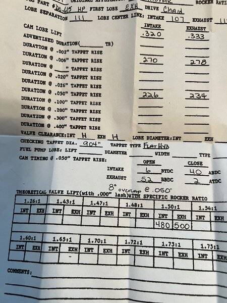

There is an error in post #1. 111 LSA, 107 ICL, 115 ECL. LSA should equate to ICL + ECL divided by 2, but it soesn't...

You are 12-13* short of the .050 number. Something looks off to me. If you got 214 from the wheel the ICL is 101
214/2 = 107-6 (IO BTDC) = 101
What were the numbers for the BTDC opening number? 12 or 13ish? If the BTDC number is in the 12 range the ICL is around 95.
The LSA is 111
says Lobe center line: 107
The 107 is what I was adjusting for!
Was I supposed to adjust to the 226 \ 2 = 113 ?

Your math is wrong... no consideration for the BTDC opening event. Also you should be at 226 if measuring at .050, not 213. No way is the process done correct IMO. If it is it's just by luck.
Coming up short on duration - Most likely because the tappet wasn't on the cam after you went past max lift. You have to push it down in the bore lotsd of time to get it back on the cam surface.

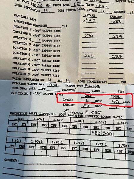

In your case with the valve opening BTDC, here is the math. Intake Centerline = (duration ÷ 2) – IO
You need to COMPARE the numbers you see on the wheel to the values written on the cam card. In this case the intake open at 6 BTDC and the intake close at 40 ABDC. For 226* duration at .050
The problem that you have is that those numbers will move. If the intake opens at 12 btdc, it will close at 34... you still get the same TOTAL 226* but the phasing of the cam in relation to the crank is WAY off.

If you had mentioned using max lift clearly in the first post, things go different. The .050 value is used plenty to get ICL. Tappet lift off base, either side of max lift.
Even after doing that method, it's a good idea to go back and check the tappet lift numbers, in this case the 6 and 40 to get secondary assurance.

When you say “6 and 40” , are you meaning the moment of lifter lift to open valve and the moment of lifter stopping or valve closed added to 180 which will equal 226 duration?
That gets you the 226 number above at .050 of tappet lift. It's not the moment the tappet lifts. zero out the indicator when the lifter is on the base circle, get it to .050 lift, then look at the reading on the wheel. Should be at 6 BTDC on the way up and 40 ABDC on the way down and hit .050 going back to .000 on base circle..
I just checked it and I got 6 and 40, thanks for the explanation.
thank you for your patience and not giving up on an old man... I appreciate it
