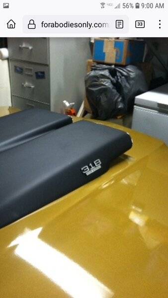

Have you seen any Australian "318 FOUR BARREL" emblems down there that people can buy?
