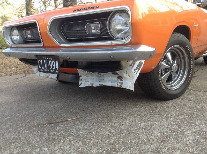

Saw this on a "For Sale" post and didn't want to clog his add with my observation/comments... A nice 2nd Gen Barracuda lower valance.
A detail often missed on 67-69 Barracuda restorations is the factory Blackout treatment done to the front valance. Faded, but still visible here.
Makes these tabs kind of disappear from a distance.
Not my cars and I do not know the owners. I just did a quick google search to show the difference. Both are nice cars. One makes me want to grab a black rattle can,
but could be my OCD... “¯\_(ツ)_/¯“
Blacked out.
vs
Not blacked out.

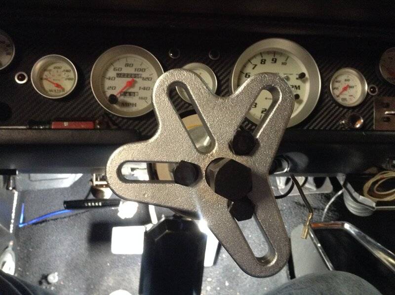

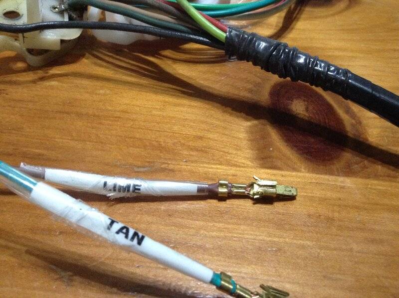

Careful when you tighten the steering column clamp. It is easy to pinch a wire. Don't ask me how I know!View attachment 1715873002 View attachment 1715873003 View attachment 1715873004
back to that turn signal switch- parts and a puller came in during the week. All going ok until I tried to sneak the wires back down the column. I found a speed bump in the wiring trough. Someone must have bent it "out of the way" at some point.
