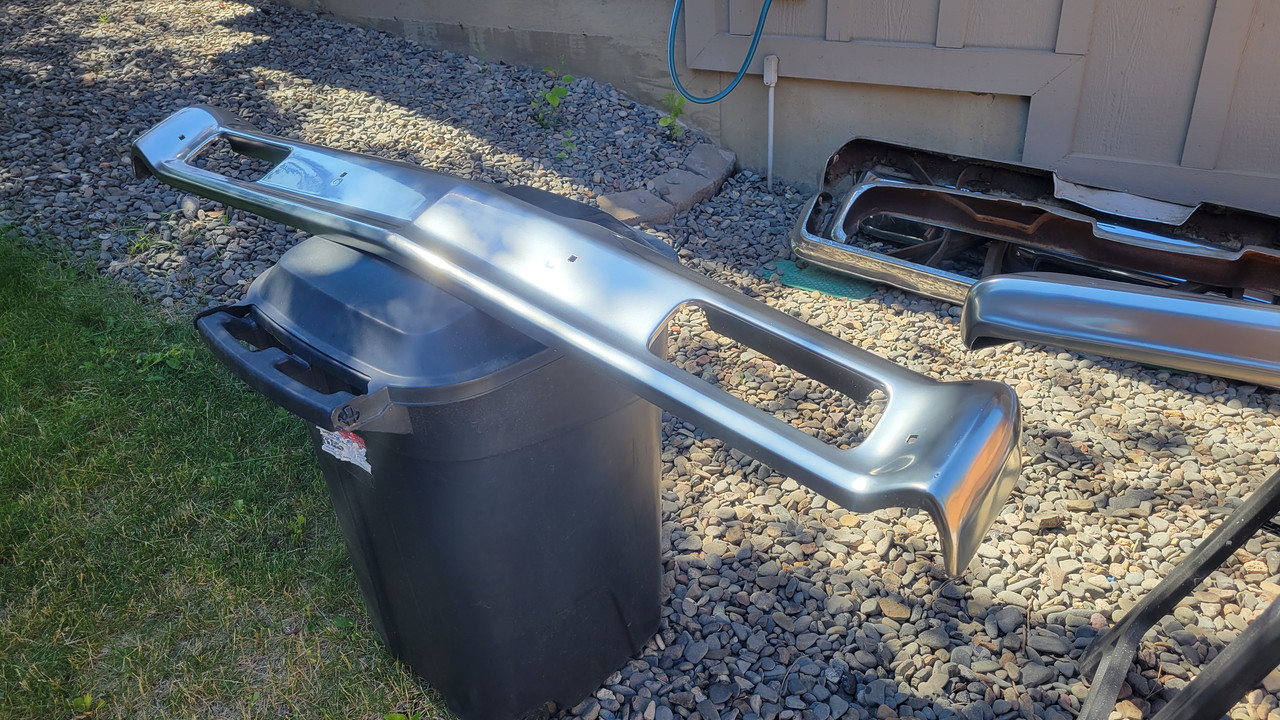

Finally done.
Since I'm not using a booth, I ended up sanding the top coat with k800 and laying down another coat of 2K black bringing the total to 3. This ensures that the base is perfectly flat and it removes any fine dust or crud that landed on the bumpers as they were drying.
Then it came time to lay the Alsa chrome paint on. This took some practice to get the fluid/air pressure correct, but at $160.00 per 6oz (not fluid oz) I couldn't practice much. This stuff is hideously expensive!
But damn, it laid down nicely! They're still baking in the sun. Evidently the longer they're in the sun, the more shiny they get.
I will top this with 2K clear in about 2 weeks. That'll protect the chrome coat.
Overall I'm very happy with how these came out. I held them next to the spare chrome bumpers I've got, and I couldn't tell the difference unless I touched them. Highly recommend this stuff.

Those look awesome!! How much of the 6oz did you use one the two bumpers. And what'd you apply it with?
Thanks man!
I ended up using 15oz total, so 2.5 of their 6oz EZ chrome containers. That gave me 3 coats. The last coat I had the fluid knob fully open and I set the inlet pressure to 19psi. That equates to about 11psi at the cap. That gave them a good thick layer without any runs or sags. The Alsa stuff is SUPER thin, so you've got to move fast. I normally paint about 2-3" per second but I bumped that 5" per second.
I used a Iwata LPH400 with the orange 1.3 cap for all of the base coats and the 1.0 cap for the chrome coat.
