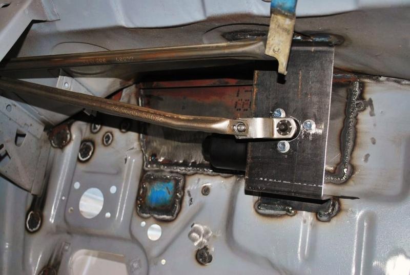

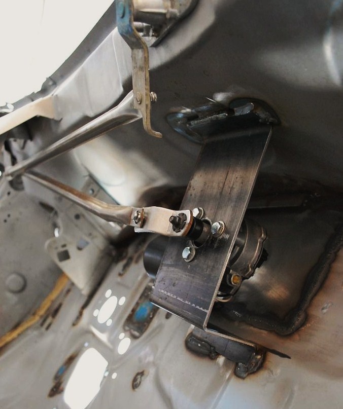

I am using an 06 charger wiper motor mounted up under the dash hooked to the stock linkage on my 67. Stock wiper motor is gone
Yeah those details add up quick $$$. I have over 22K in my 67 and its still not painted and no interior. How stupid is that? LOL
Same thing I was gonna do. I got my motor out of a magnum.
Out of curiosity, was that a pretty simple mod or a PITA?
I did that in July 2011, very easy actually, heres a couple pics, if you want to see more you can check out Page 16, Post 397 of my build........Sorry for the hi-Jack John.

Would you be able to reproduce those brackets Ross?
Actually I just took a pieces of scrap 1/8" steel, made a couple simple bends and drilled the main center hole then simply picked up the other 3 bolt holes....I don't have the template I used to make the bracket but it was easier than I thought ...so the short answer is No, especially with the car 45 minutes away.

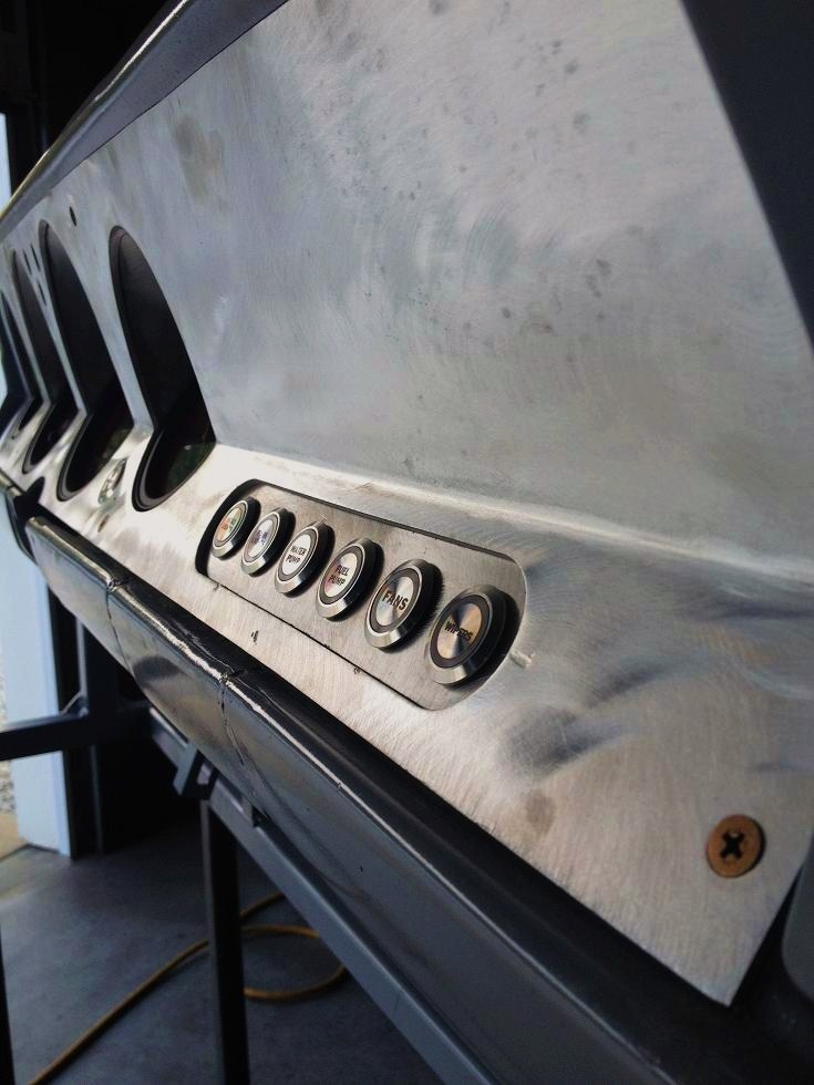

Hey, with the new wiper motor, how is it switched? Will you have intermittent function?
This one is for you Idaho. Mind you I will be laying the frame on the housing when I air out the bags.

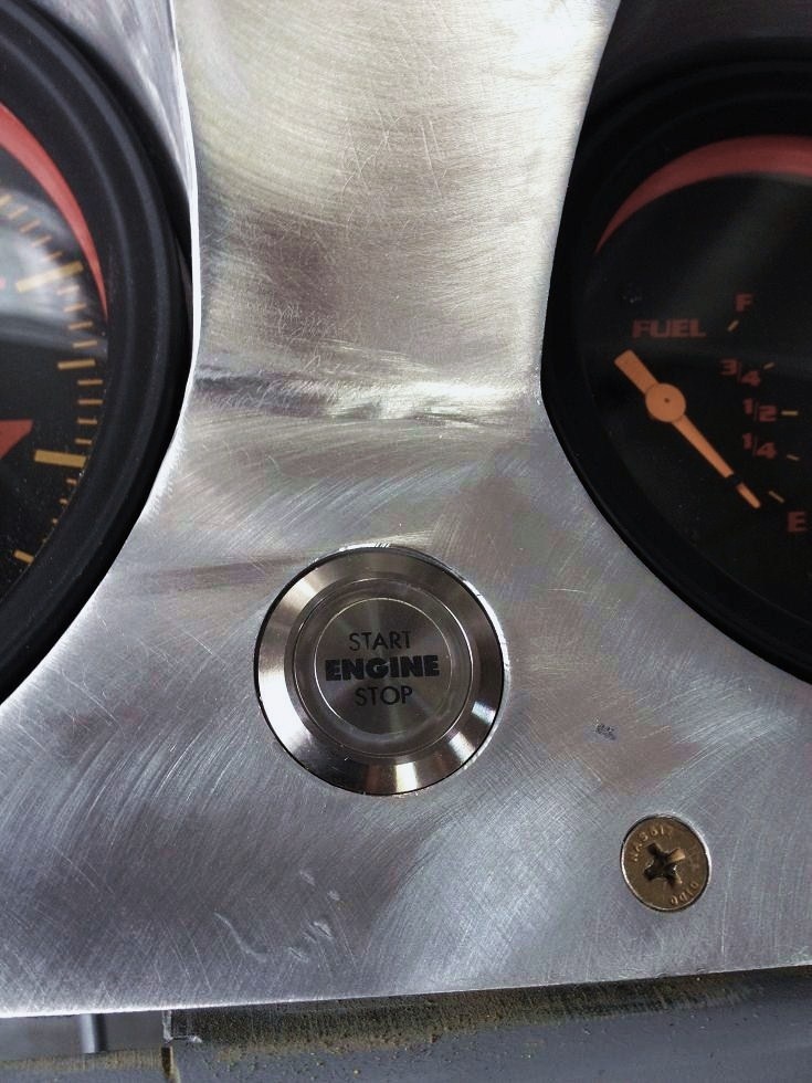

It (Wiper) will be simply controlled by a latching L.E.D button. No intermediate feature, wired for one speed....just in case I get caught out in rain. Every control will be push button L.E.D, including seperate park and headlights.
