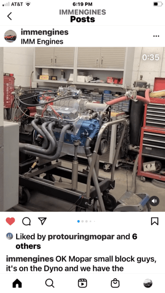

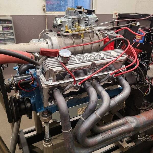

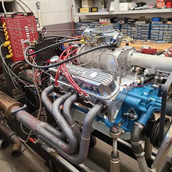

Engine was on the dyno today, 510HP /508 FT LBS TQ using a 3.48” diameter upper pulley. That’s 72% overdriven. Apparently the blower wasn’t making any boost at all, the rotors were in the way, holding the engine back.
Next try is with the 2.5” pulley. Brian thinks that should make some boost, good for around 40 HP.
Stay tuned, maybe Friday I’ll have the updated numbers.

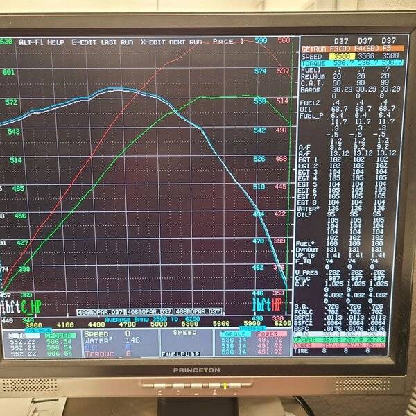

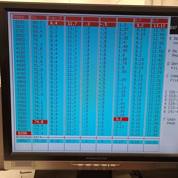

Update: the pulley worked! LOL
It produced 3 lbs of boost
579 HP
580 FT LBS
I’ll post a video and the graph later this evening.

Peak was at 6200 RPM and there was no apparent blower belt slippage, so I’m happy with that.

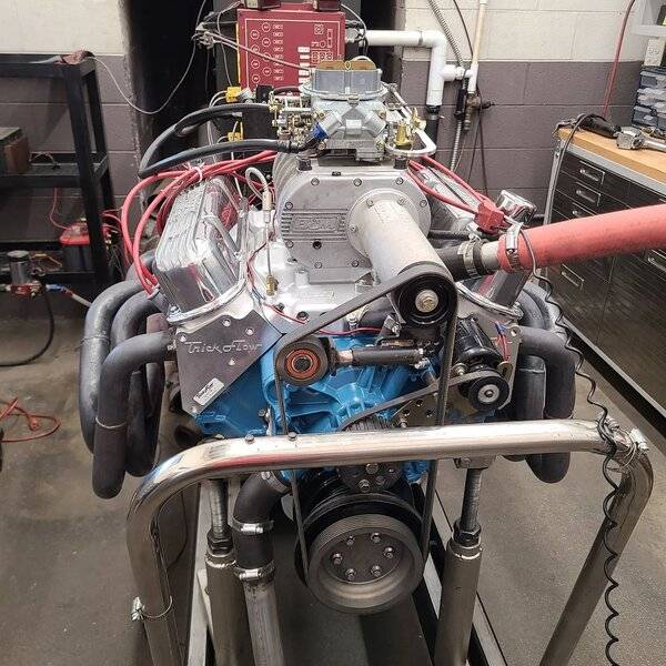

Are you running 6 rib pulleys or 10 rib?
These are 6. I’ll see if I can get my 10 rib system to work, once I have everything in hand. It’ll be a little bit, the 10 rib idler is on back order.
