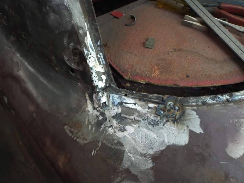

OK, I got back at it this mornin. Couldn't sleep.....again so why waste car workin on time, right? Made my "corner end" patch. Ground all that stupid lead filler out. Found more rust. Cut the bad out. Welded the little split up above the patch. Welded the patch corner in and welded a few holes up under it. Ground it all smoth for now. Gotta make some more patches for the window channel. Fun fun. But I'm "gittin it did".

Aight den. Here is the preliminary patch all welded in. Lemmie tell you, with al those panels comin together in that corner! DANGIT! What a time I had makin all those complex curves and bends. More grinding to do of course and then a small amount of filler to get it perfect.

I appreciate that, but lemmie tell you that corner really tried my patience. There are actually several small patches in there. That's just "how I had to do it". Just look at that bottom rail where the back glass sits. Not only is it curved, but it's got a vertical, then horizontal and back to vertical, ALL WHILE "goin around" the turn and into the pillar. I had several other pieces tacked in, only to get pissed off because they weren't good enough. I actually think I can get this dead perfect though with some more finish grinding and filler. It basically looks "just like" the other side now.

I used my bench vise, vise grips and regular pliers. The largest patch was about 4" long. I bent the two 90* bends first, sectioned it in 4 places with the whiz wheel, then pressed it against the bottom pinch weld and molded it into the shape of that curve. Tacked it on and welded up the whiz wheel slots. I worked on it probably about 20-30 minutes at the time and then left it be a while. I cannot just keep at it. I don't have the patience, so I have to do it in steps.
