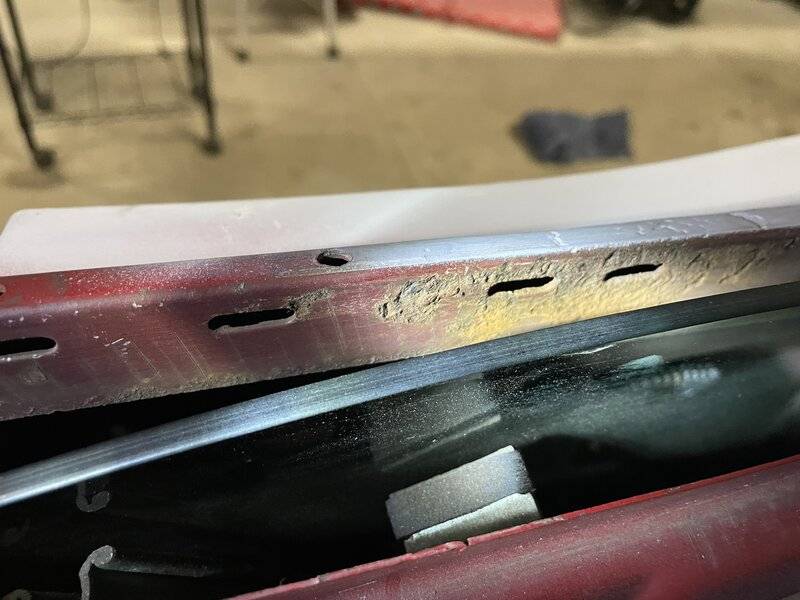

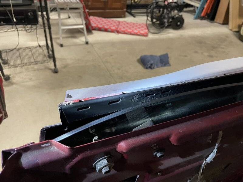

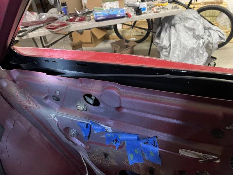

It is the little things that can bother me. On the rear windows, on the passenger side especially there was an area of rust that was forming under the chrome trim that runs on the tops of the doors and along the rear windows.
Also inside the window frame where the outer window fizzy are installed there was corrosion. I have sanded them and then went to the trouble of painting both of them. It will never be seen again, but now I will never think about it again.
