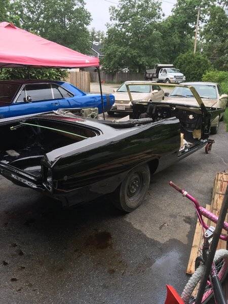

Quarter was solid. With the skim coat it looked like a lot of Bondo.
Here's my new quarters. Best saving yours.
They came out pretty good. Definitely bottoms are firm. Starting with carpet above the burlap over the springs.

Delivered for paint. I got a compliment from the shop owner and his main man.
I rolled it off the trailer and then unhooked my trailer to leave it there. When I got back to the shop the Dart was rolled out of the way. We went over all the little areas I had circled. Showed them where I blocked too deep etc.
Then Paul said we thought you had left and we were saying everybody says it is ready for paint. They never are per Paul and Shaun, but you are the closest since we opened the shop. I take that as a win.

When I went to the shop today, Shaun is having the shop rework every panel. I brought it to them with all the metal work finished. Then they fixed all the dents etc, then I worked the car after priming (blocking it)(I got my big compliment-pretty close to paint ready/it was not), then his apprentice reworked the dart, now Shaun is going over the entire car to really get it ready for paint! He noticed things I had missed that have to be touched to be found even with blocking. It is like waiting for Christmas.
This is the last quarter to be touched before paint.

I finally laid eyes on the Dart today.
It came out pretty good. There is some trash he is polishing out. It should be ready tomorrow. I checked all the areas I was concerned about especially under the rockers. The coverage was great.
