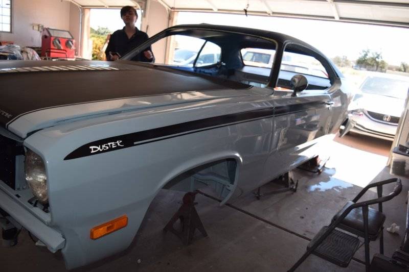

Stuck the window in just for effect but we did finish the stripes.... sort of..... It started out great.
Then the tail panel kicked our butt. Yes it is crooked and yes it is full of bubbles. Will be ordering another. The shape of the panel is not factory as I had to do body work there so the right way is to cut this into 4 parts and have an overlap in the middle. That would be much less noticeable than the eight thousand bubbles.... She voted for the Twister sticker. I think it looks great with it. I like the way she made it follow the stripe instead of level with the body line..
