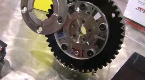

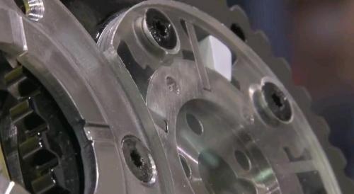

timing set

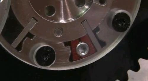

Limiter

Well thanks fer asking. I am in the process of putting a early version cam sprocket on a vvt engine to eliminate the phaser if it works or not I will post my findings .
Also to understand this a bit better I did some digging into the mechanics of the phaser controller which is a solenoid that directs oil pressure to either side of the vane in phaser. When there is no signal from solenoid it is in neutral and so is the phaser so if isn't hooked up to the computer the vvt does not move So in my opinion a phaser lock is an expensive alternative to do nothing that is already done by the engine itself. But this is my 2 cents
Some of the info you've been posting in MY view, is ground breaking discovery compared to the info that's been out there thus far. Please keep it coming. Some of it I'd want to double check myself before implementing (that's just how I am), but it is refreshing to hear compared to something like the Comp Cams alternative. A company like Comp Cams is not necessarily going to be looking into what pre-'09 parts may work on a '09-up engine. There's not much money in that for them. They're more inclined to want to come up with a PRODUCT they can sell us.

I looked into this again to verify my understanding and once again I found that the phaser is at full advance when the engine is at rest or at idle in stock configuration. The ocv, oil control valve, operates at 0% dc(duty cycle) to 100% dc. Zero% dc is full advance and 100% is full retard. If there is no power to the ocv the cam will remain in the full advance position. I read this on several sites and on several threads involving professional engine builders. But this was not enough for me so I called a couple builders for confirmation. Both of these guys who have built dozens of these vvt engines confirmed what I have stated above. I will not name these guys out of respect for them.
Don't believe what I'm saying? Good! I'm a skeptic too! I suggest you call Dave at Modern Muscle(FABO site sponsor), Andy at PRW, Stu @ Inertia Motorsports, Mike @ OST or any of the other builders out there like Arrington etc.
While you're at it, ask about the early 08 and older timing set on a vvt engine. Chris at Modern Muscle already addresses that in a post above. But please, verify it by your own hands on means.
