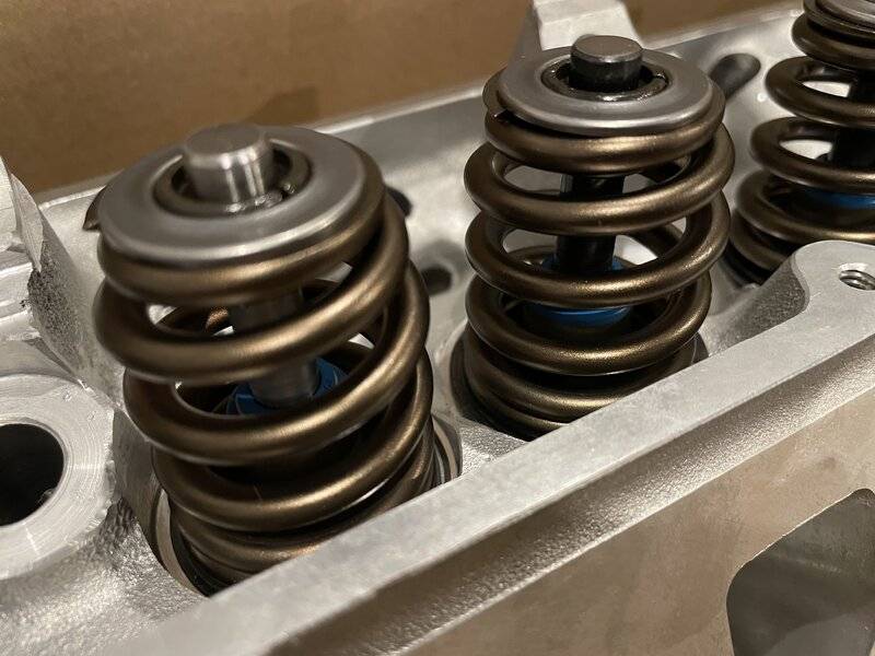

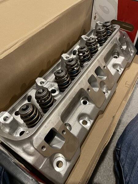

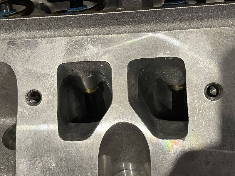

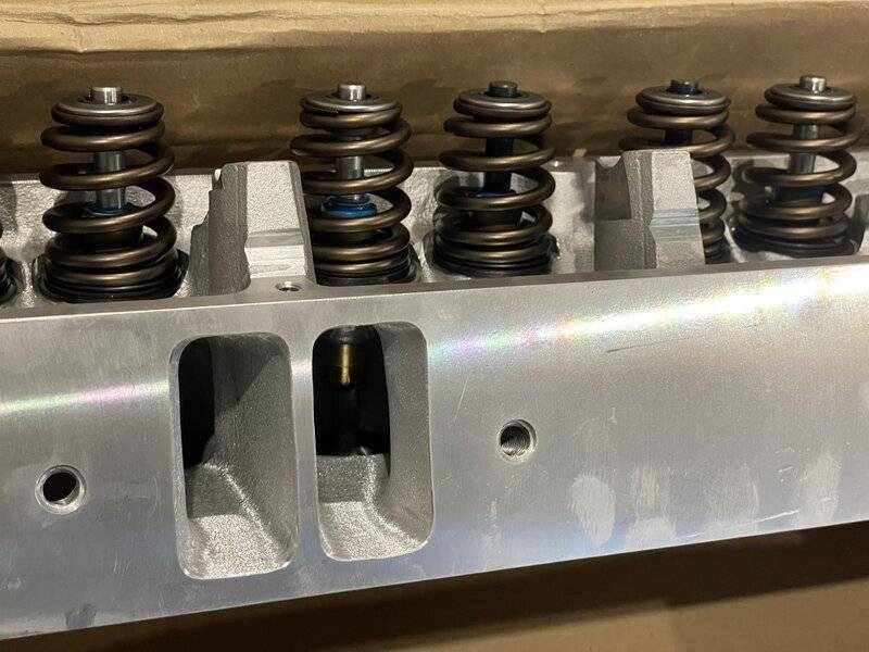

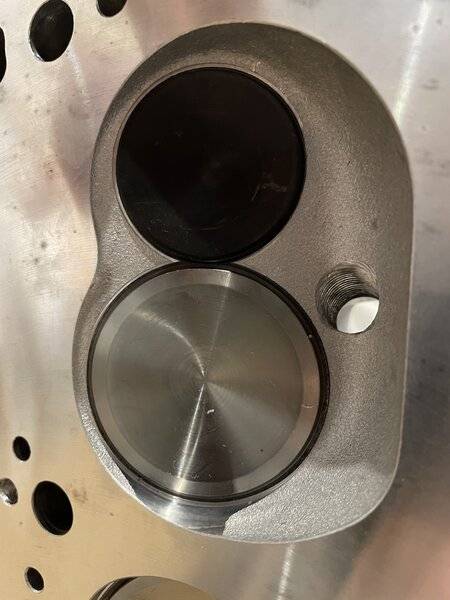

Heads are Edelbrock rpm, photos attached. They were bought bare and fully done with good parts.
I didn’t cc them, nor the pistons.
Heads should have 63cc chambers and pistons have 6cc valve reliefs.

The chamber could use a little work, I'm surprised they didn't touch it during porting.
That’s probably going to be some way out. I can work on the chambers but it’s not going to make that much of a difference.

It will make more of of difference than you think, if done right. The chamber has a lot to do with detonation.
Did use use the 0.039 x 4.180" head gasket in your calculation or the 0.039 x 4.04".
You have to be careful opening the chamber up bigger than the bore.
You can create more issues doing that.
