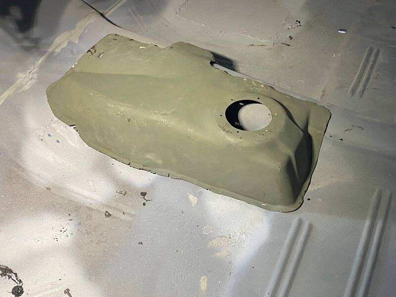

The shifter hump as arrived;) I was getting a little worried, but usps came through~ Marc (bb66cuda)(did a great job packaging, now a little trimmin and all will be GREAT! ;)

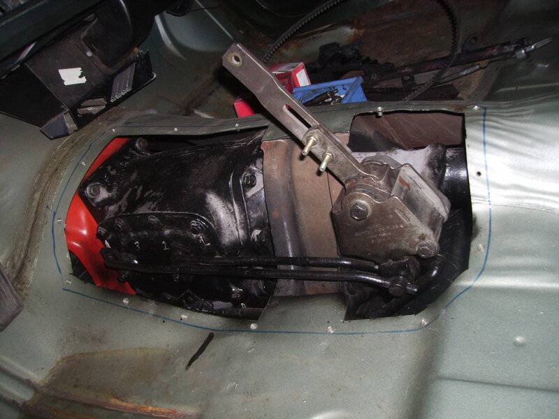

when i swapped to 4 speed in my 68 valiant i fitted small nutserts to the original floor and tunnel around the new hole. that way i could bolt the 4 speed hump in place which with it removed made installing to shifter rods much much easier. just something to consider before you weld yours in place for good.
neil.
neil.
Neil, I like your idea!! On my triumph tr6 ,for the trans tunnel, I welded in 1/4 weldable nuts, nutserts sounds easier;) Do you buy those as a kit, like rivets?
here's what it looks like and the superb access a removeable panel allows you.
neil.

I'm converting my 65 Barracuda to a 4 speed also. I'm going to hold off welding my 4 speed hump in until I get the transmission mocked up. My hump is a 64-65, just like yours. I might be overthinking it, but I'm guessing with that itty bitty hole for the shifter handle....the hump placement may need to be pretty precise. 66 model humps had an elongated hole for the shifter, like later A bodies.

i pressed the 'hump' down while wiggling it and it settled in one place fitting the floor contours all round. i drew round it and cut the floor about 3/4" in from that line. the hurst comp' shifter with 'a' body bracket lined up in the hole spot on, but as you say the hole's much bigger in the later hump. worst way you elongate the hole and use a different (later) boot and bezel.

Worked on the new to me hump~ looking great!~ sorry, pics are in the wrong order

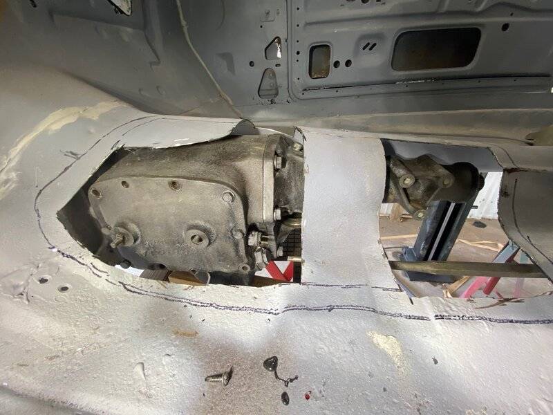

My plan is to cut straight, being careful not to cut the crossmember. Then tack the dogleg down to the floor pan. On the shifter side, I will leave the floor pan metal on top of the crossmember to strengthen it and also keep crud out. The factory did it that way, so it's good enough for me. :)
agreed, cut it straight first and see what's under there. if doesn't ' need' to be cut out why do it. that bit can still be bolted down though. on my 68 i found the tunnel wasn't spot welded to the crossmember on the section to be cut out. almost like ma mopar knew we'd be cutting it out for a 4 speed, lol.

oh, and anyone wondering what the 'shift lever' is it's an old alternator bracket i used for setting up the shift rod lengths (i didn't have the right ones, lol).

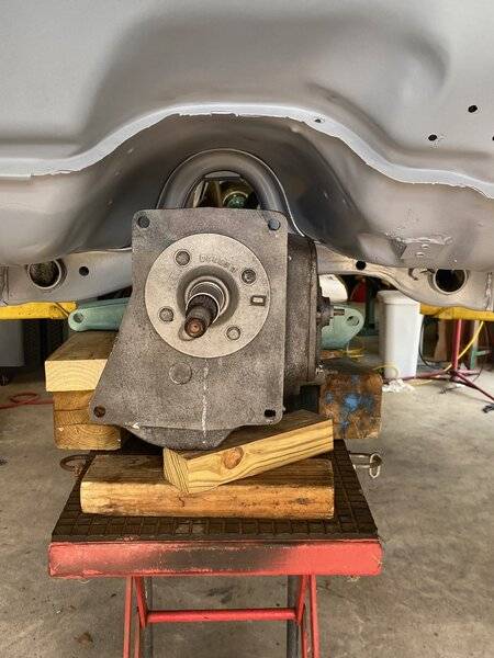

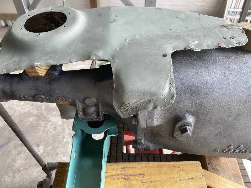

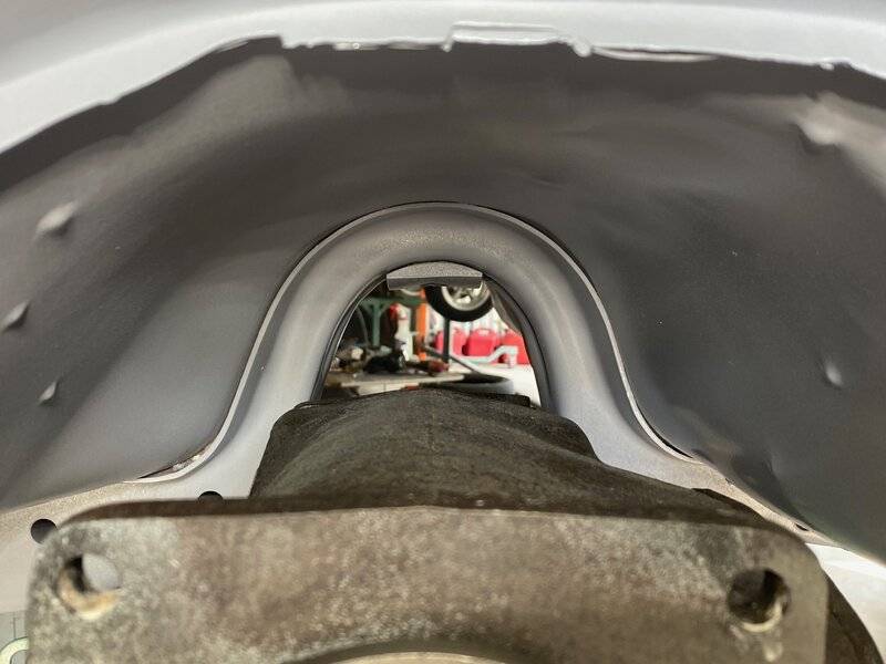

I had a little time before we go do other things, I used my old motorcycle lift to get the heavy A833 up to the floor of the Dart just to see how it all works. I now understand the dogleg thing, so that makes room for the shoulder of the right side of the transmission. Makes sense now. I have a better idea of what I need to cut out come Monday. Need to spend some time with my husband~ it's easy to get caught up on projects and vanish for hours on end!

I'm referring to this funny thing as the dogleg
now it makes a little more sense of what needs to be removed;)

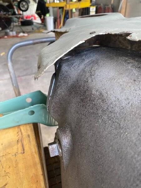

You may get to it before I do on my Barracuda, so when you get to the mock up point with the motor and transmission sitting where the will reside....check the top transmission to bellhousing bolt on the passenger side. Seems like I remember them being really close to the floor pan. Back in my late teens or early 20's, I bought a 65 Barracuda Commando 4 speed car. Someone had cut a hole in the floor pan above that bolt, with a hole saw, and had a round plastic plug in it. You could pop the plug and get a box end wrench on that bolt much easier than wrestling it from below. It may be something worth doing to prevent future cuss fits...lol. I'm sure gonna eyeball it on my Barracuda.
I'll look into that soon! The next time, maybe tomorrow, I'll cut most out of the hump and re-evaluate the cut, then bolt the bell housing onto the trans~ put the trans up and see how that looks, and post my findings;)
Just a bunch of pictures, I see what you mean JD by the top left bolt on the transmission at the bell housing, hard to get to. Maybe a plug might be in order, just ran out of time to look at it. I'm strongly curious how the one linkage gets to the lower lever on the transmission? I still have some trimming to do, got a little narrow by the gas pedal, then clean up all the burring from cutting. everything is accessible, maybe just cleaning up the raw edge, priming it etc.
The bolt you're talking about.

I started to cut this piece out, but left it as doesn't seem to be in the way and maybe offers strength to the torsion bar thing

The hard to get to bolt
Direction of the hard to get to bolt, perhaps when the transmission support is unbolted, then the transmission tail lowered may allow a really long extension to get to it?
