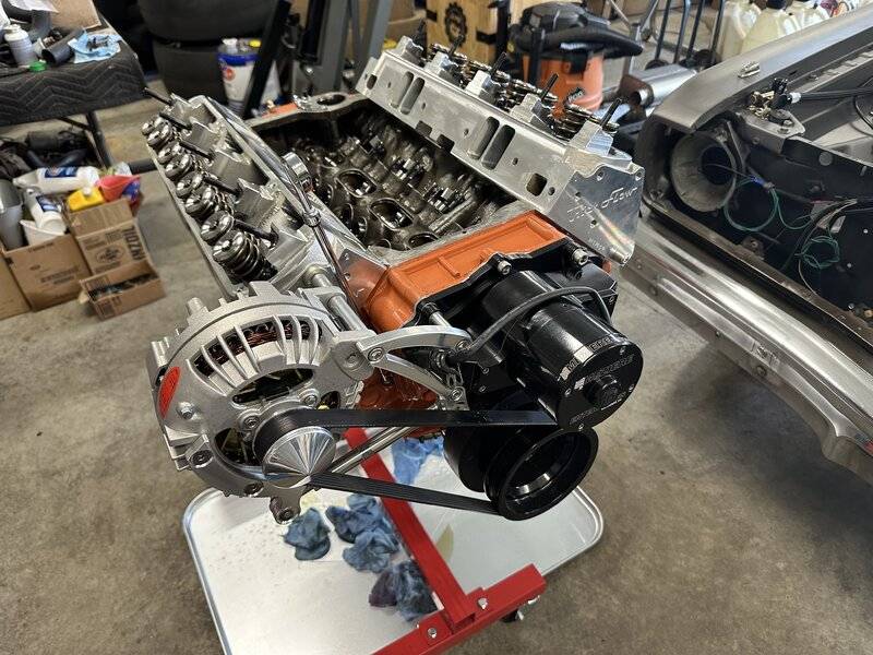

The nut definitely backed off causing the carnage. In fact, that entire bank wasn’t fully torqued. Damage so far is 3 rockers, 4 adjusters, 4 pushrods and of course the rocker shaft. Won’t know more until I tear the engine apart and check everything else.

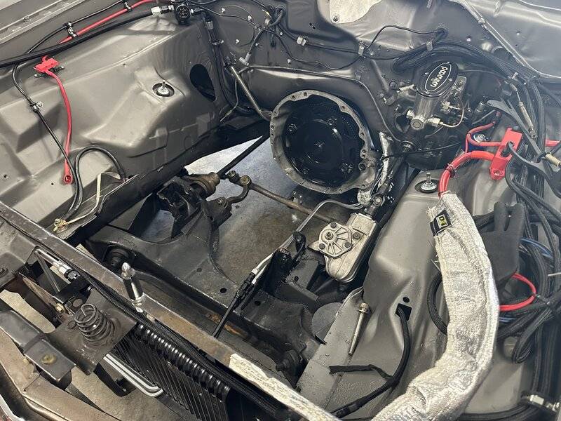

Good news. Engine is out and no additional issues found. Spoke to the builder and the rocker shafts were torqued to the factory spec 17-18 ft lbs and not the Trick Flow spec for their studs which is 25 ft lbs so now I think I am confident I know what happened. New parts are coming (4 pushrods and a half set of Harland Sharp rockers with shaft.) Engine will go back together with the Trick Flow intake as I am sending John the 340 to do his magic and back in the car next weekend. Hopefully weather will get better so I can finish heat cycling the rear gears and get my burnout video.... lol
By the way, look at how good the intake gaskets match up to the ports on the heads....

You did all that work and you're going to cut out the inner fenderwell later ?
That sounds like some stuff I do lol.
Not on my junker this time, I needed that steel for other parts on the car

Yes, Hemi orange.
Inner fenders will stay on until next winter when I go crazy and go full tub/big tire. lol

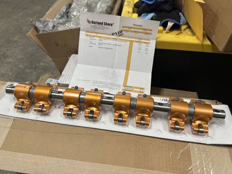

Just got a call from Harland Sharp. My replacement parts are getting shipped today and I will have them before the weekend. I can't begin to say enough about the amazing level of support I got from Randy Jr and the team at Harland Sharp. I might have said it before but I will say it again.... They have earned a customer for life.

UPS dropped off a few boxes today. I went straight for the QA1 stuff as I wanted to get them installed tonight which I did but there were a couple of boxes I hadn’t opened yet and one was from Harland Sharp. Unbelievable the customer service I received from them. Even though the damage to the rockers wasn’t their fault, they came through just like they said they would and sent a whole side, free of charge. I asked for expedited shipping which I paid for but otherwise, this is what they sent!
