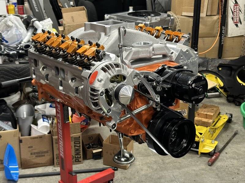

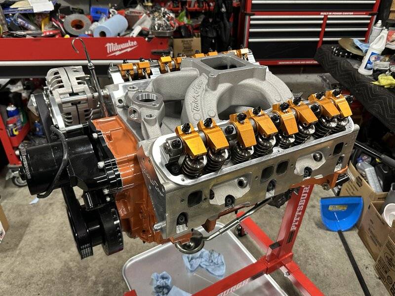

Whenever you want to turn that trickflow into a dominator flange send it down.
I'm going to give it a try out of the box. Measured, marked and lined up all the ports and it's almost perfect to the Trick Flow heads. Lines up better than the Victor340 did. The oversized holes makes it tricky if you don't know how to take advantage of them and I think I got it lined up perfect.
Good to know for the future though when I go bigger! :p
Little bit of a late start this morning but I’m back after it. Got everything buttoned up and the engine is ready to go back in the car.
I figured it would.
Makes it nice for the assembler but not for the guy doing the porting. The builder can dry assemble it on the engine and determine the best location then mark it. Lift it off and apply your sealer. The porter can’t do that. I think it’s an idiotic move to slot every hole on any intake unless it’s necessary.
That's good, I had the same deal with my tunnel ram and trick flows, I put a lot of thought into making sure it was going to be perfect.
Yeah, we talked about that. I’m bummed it didn’t work out like we had hoped. Oh well, it will be a good interim intake until I get the other one back and on next year.
Got it in and buttoned up. Valve covers, cap and wires in the morning, then I’ll fire it up and take it for a drive…. Even if it’s raining! :lol:
