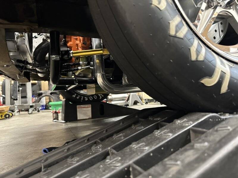

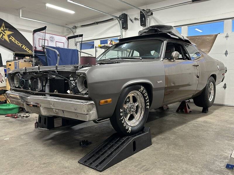

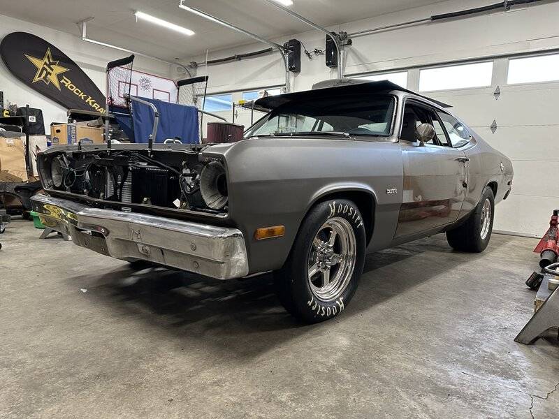

Seems like the QA1 k- member and control arms don’t have the exact same geometry and what they replaced. Just need to crank up the torsion bars a bit more to get the ride height where I want.
As much as I like the looks, ride height needs to go higher…. lol
Finally got it out but not before the rain started up again so no smokey burnouts.
Freaking awesome lol, I love the giggles from your buddy and the stance looks great, is that where you want it or still higher
Glad you got it back together so quick. As far as the smokey burnout's, just go first to second and then bury the pedal and it will do a very nice rolling burnout.
lol, he’s a good dude.
I think I’m going to raise it another couple of turns (1/2-3/4”) and lower the back an inch.
I did that once but with the ground being wet, it didn’t have the same effect. Also did a little blip/spun tire in 2nd gear in my driveway when I came back. lol

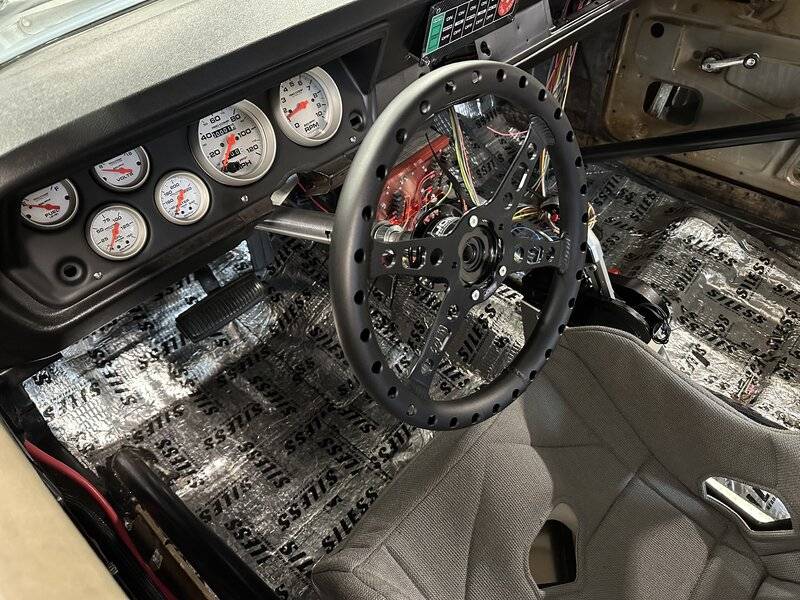

Got the Twisted Metal column and Joe’s Racing aluminum quick disconnect/steering wheel installed. I ended up shortening the column by 4” to put the wheel right where I wanted it. I probably could have used a different disconnect but I like how it ended up. All in all, it’s an extremely light setup weighing just at 11 pounds including the disconnect and steering wheel
Nice product but if I wasn’t lazy, I could have made my own but it’s in and done so that’s all that matters. lol

That looks good, I probably will get one of those.
I'm having to fabricate almost everything on my car. Getting 1 thing that's easy won't hurt my feelings.
Is the quick disconnect 5 bolt??
Do you like the steering wheel also ??
