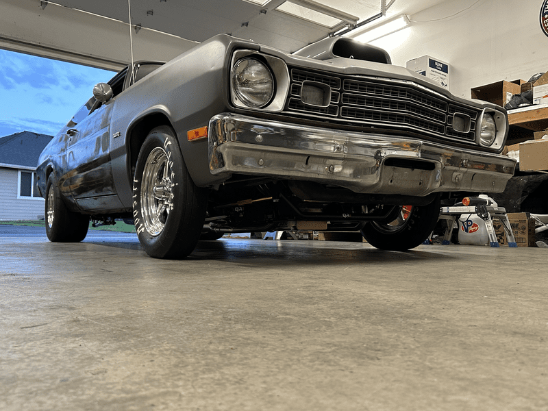

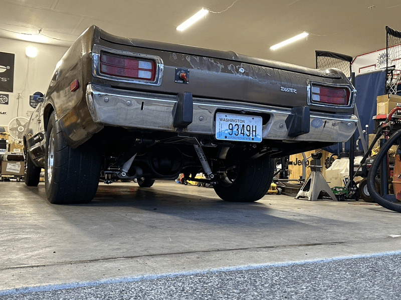

Damn, that's looking tough!!!Well, since the roads were too wet to do any tuning today, I decided to lower the ride height in the rear. I think it needs about 1/4" more to be perfect and since I need to correct the pinion angle now, a correction shim might get it there.
I went with the standard height split mono leafs. Dropped an inch by going from the middle hole to the upper on my inboard springs perch.What Calvert springs did you buy stock or 1" lower? Also what did did you set your pinion angle to? I've always set mine to 1* negative but when I did that with the Calvert setup I had a hellish vibration. I ended up cutting the perches off and setting it to 4* negative. Unfortunately Calvert lists the 4* negative on their website but not in their instructions.

That's basically how mine is but I also ended using the 1" lower mono leafs. Prior to getting the Calvert setup I had SS springs with a 1 1/4" block between the spring perch and and the spring, so I knew that 1" lower would keep it basically the same height.
