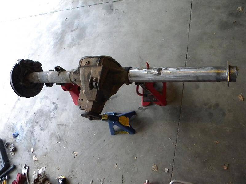

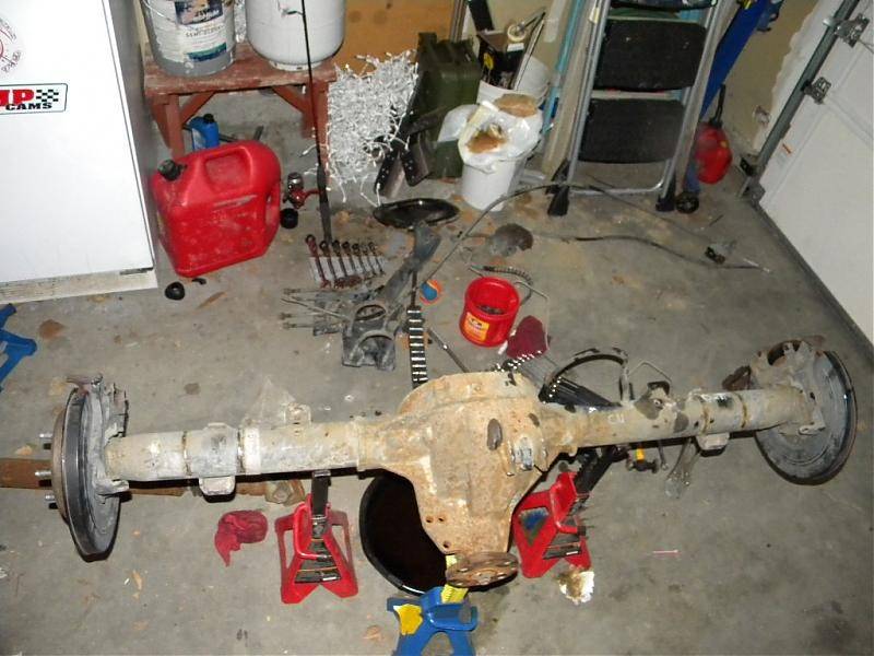

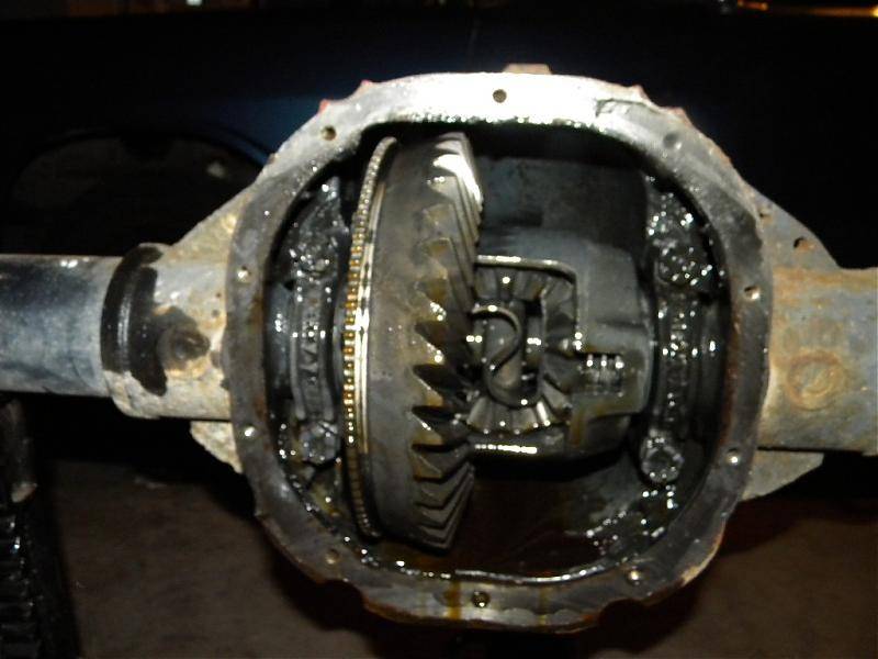

I got a 8.8 out of a 97 exploder this last week. It came with disc brakes, limited slip, 3.73 gears, complete driveshaft, u-bolts and brakets all for $150. I'm going to shorten the long side axle tube and center up the rear-end. That will bring the rear within an inch of the factory A-body rear. It will also let me use an extra short side axle shaft, so no custom axles. If your wondering why not get a 8 3/4 well I plan on doing the whole swap for around $200. You couldn't hardly get a bare A-body housing for that much!
Here's a few pictures. I'll post more as I go along. I'm going to move the rear springs into the frame when I do the swap also.

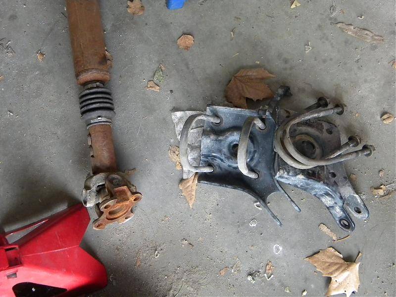

I have the drive shaft flange that bolts to the rear end. I just need the conversion u joint from it to the drive shaft. I've heard they're stronger, smoother, just alot more modern benifits.
It's at the other end of the shaft from the picture, but you get the idea.

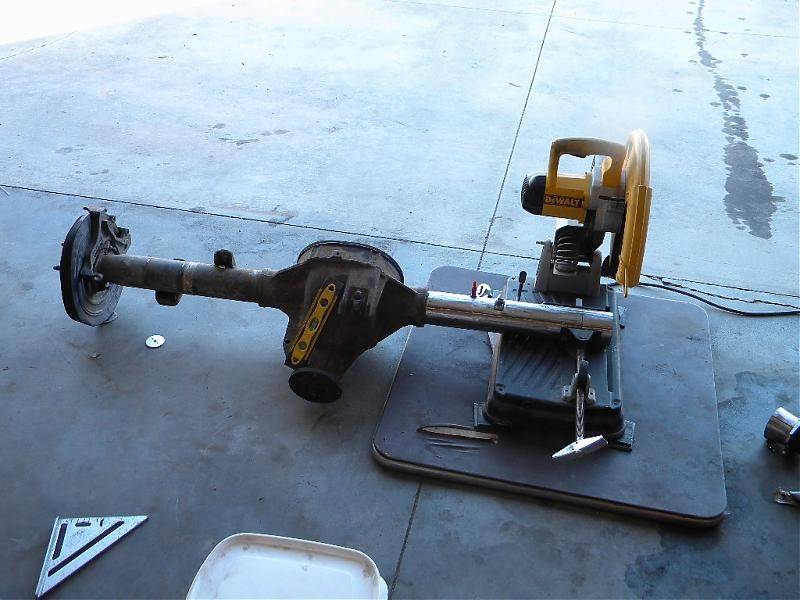

I got the housing cut down today. I was pretty nervous about it, but everything seems to have went okay. Now I just have to build the frame boxes, get a shaft, u-joint and It should be ready to bolt in.

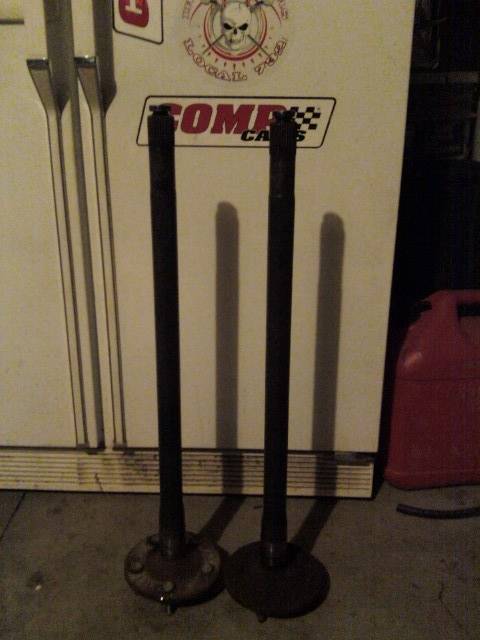

I got a little bit done today. I picked up the axle shaft I needed. $26, pretty good especially for how easy they are to pull! I got the axle tacked back together too. I'm hopin to get it welded up tomorrow, and start putting it all back together. I also picked up the sheet metal and round stock for the spring relocation. I'm starting to get excited to get this thing in there, and do a big (2 tire) burnout!:cheers:

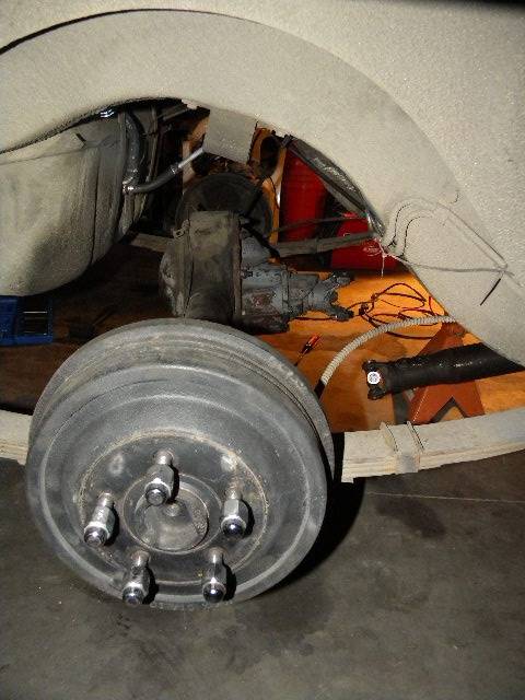

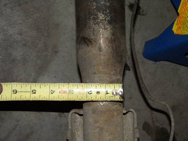

I started on the dissasembly this morning. Some one who owned the car before me welded a trailer hitch to the frame. I'm probably going to leave the 1/4 inch plate on the frame, since the leaf's are wider than the frame anyways, it should just add some strength.
You can see the big difference in rear-ends. The 8.8 has a whole inch bigger axle tube than the 8". The axle shafts themselves are a lot larger on the 8.8 too. I'll pull one later and take a picture of the two. For now here's a couple pics.
