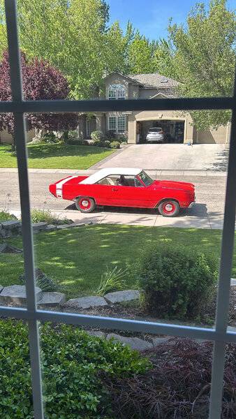

If your referring to my car it’s a 69 340 4sp Swinger with 3.91s . 4” Stroker , W2s , solid roller .
Day 3 car . Stock appearing .
