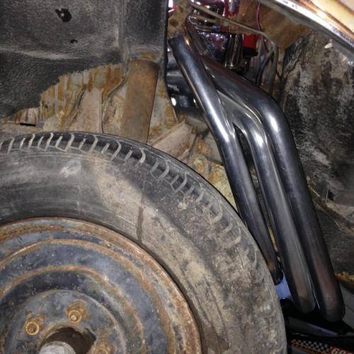

I couldn't even get the headers past the exhaust studs when in the car, had to go to bolts it was that tight. I fashioned sheet AL and just cut it to fit contours of pipes and sheet metal screwed them over the massive holes. Looked OK I guess. I believe those tubes are smallish but better for 90% of apps. As I have always said, check exhaust flanges for accuracy, my holes were drilled too low making the bottom of the port seal hair thin, kept blowing gaskets.
I couldn't get a bolt in the #7 tube inside location. It's a bear to start a thread. Maybe it's the flange accuracy like Pishta says.
Tubes are 1 5/8"

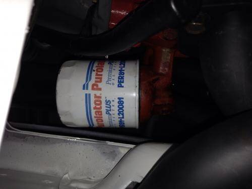

In the end result does it look like these headers need a 90 degree oil filter adapter ? Looks like it will work with out one, pettybludart took his off he said.
I found the 90 degree oil filter to be more convenient but I think you could sandwich a short filter in there without the 90 adapter.

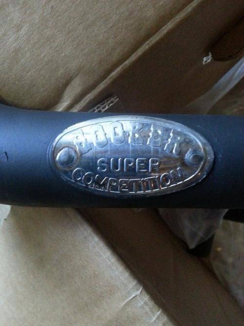

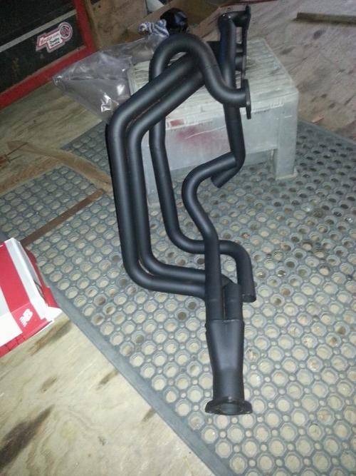

I pre fit the headers to make sure they sent them all and looks like all is good :glasses7:

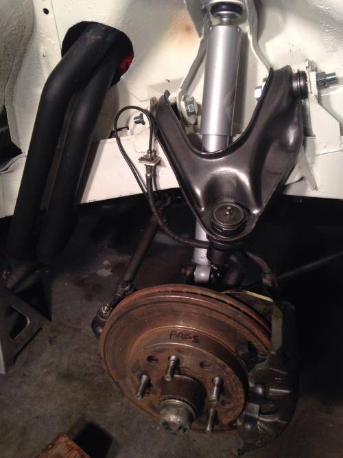

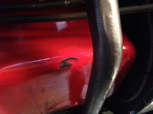

5208 Hookers on my 66 Dart, I installed these a few days ago. This website/forum has helped me out so much.
Here are some pics of mine....I cut the hole smaller, but made a cover, most people never even notice a hole is there :glasses7:
