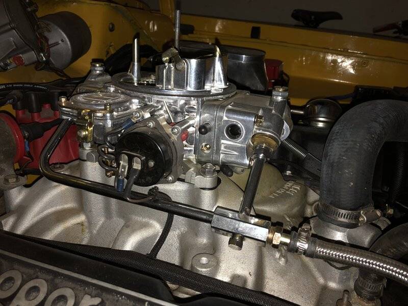

Alrighty...I think I may have some hood clearance issues with that, but we'll see. I've got quite the parts list going! Lol
There is a thin insulated gasket/spacer you can buy.
However before buying parts, determine the source of the the problem.
A carb spacer will not solve heat issues in the feed line.

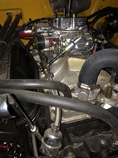

Fuel filter angle looks good.
You can do a bunch of investigating. When it won't start, take the air cleaner off. Is there fuel dripping (over filled bowls)? Open a siyte plug to check levels. (have a rag ready). One reason it won't start is flooding (vapor pushed extra fuel into the bowls) and the other is vaporization in the carb (not enough liquid fuel - or not enough of the light molecules still in liquid state). Different causes = different solutions

You first need to determine the cause of the shut down and no restart.
Is it electrical or fuel BEFORE you start assuming it's one or the other.
Seems like everybody missed post #35.......
That is a sizeable cam & will have a rough idle. If the initial timing is still at factory specs of between 4-15* [ 12* is typical ], then not only will the idle be rougher than it needs to be....but the engine will run hotter at idle & low speeds. The idle timing may need to be as much as 45* with that cam.
If the ign timing is still stock, then here is a simple 5 min test: engine idling, loosen the dist clamp & turn the dist slowly CCW; this advances the timing. I have not seen your engine, but I know what will happen: idle rpm will increase & idle will get smoother.
This happens because the additional timing makes the engine more efficient & it runs cooler.
IMHO
Actually I’m not assuming either. What I’m assuming is the heat is the problem: heat can cause fuel boil causing vapor lock, and heat can cause expansion in the coil and/or distributor disrupting spark. So, I’m shielding lines first and looking at the radiator efficiency specifically to isolate the electrical. My premise, hypothesis, is heat is the cause and the other two are symptoms of that cause. Yes, I’m treating one of the symptoms first but I after reading the bulletin and understanding how easy it is for fuel to evaporate, I think shielding the lines is prudent anyway. That’s why I chose that as a starting point.
Get the basics down from the real deal the factory books; then principles, and then you can start to seperate the wheat from the chaff.
surprise, there's also bad information posted on the internet forums.
Yes yes I think we all agree.
It seems likely its fuel, but having a spark tester on hand will help verify that the next time it happens.
Even knowing its fuel, need to determine if its too much liquid fuel into the intake manifold, or whether too much is vaporizing (either in the line or in the carb).
Since we know it runs cold, he won't be able to investigate all this until it happens, or at least is hot enough it might show symptoms upon investigation.
