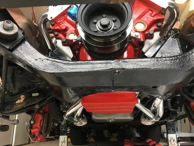

Header fitment rant, Doug's
The isolator mancini shows on their website is the same as the ones I have.
I kinda expected I would have to raise the engine a little and tall/thick isolator helps.
This is the driver side header I received initially, I sent it back because of the piss poor machining. Tell me about quality control.

That mount I bet is the problem, it doesn't look like the engine is in the right location

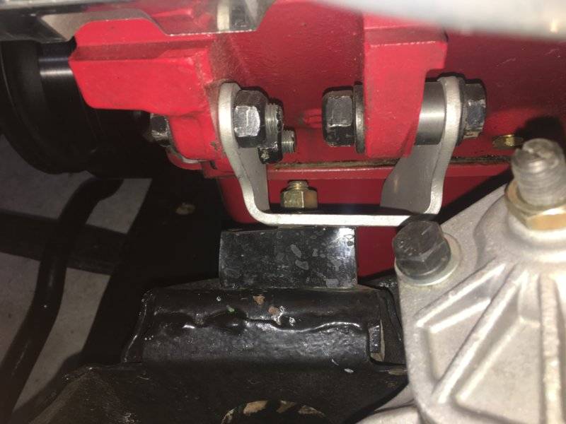

Moa when I get home I will check my one and take a photo as I am running the same mounts . Here’s a photo front shot I put up previously . I will take a top view pick tonight.
Here you go I hope this helps manual steering though. This is a 360 so drivers mount will be different.
Looking at my mount pic reminds me I need to change those bolts little short on a few. I forgot to address that when I was fitting them.

Your orientation of the brackets looks correct. These are pics
of my original brackets. I think yours match up the same except for possibly the thickness of isolater part?
