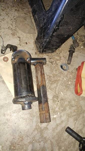

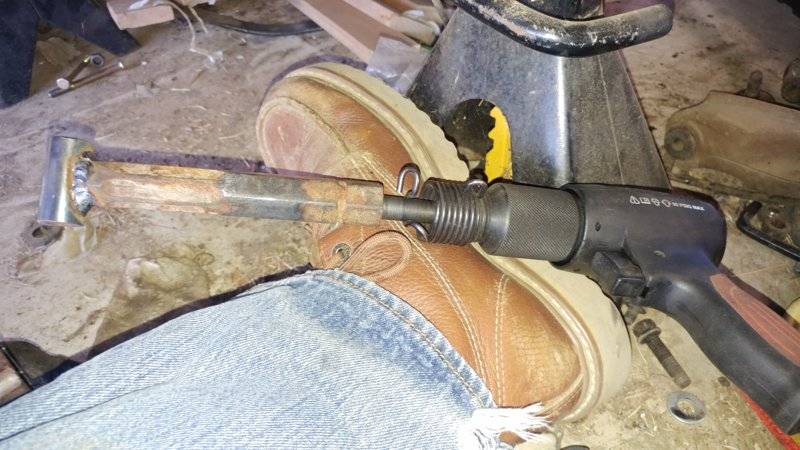

        Tried to install drivers side torsion bar today, hits the headers, .990 torsion bar.
        Since I'm not going to take the engine out for the 10th time, I made a tool that fits on my air hammer to get into that spot. I'll post a pic later.
        I could say that I'm getting used to this kind of thing, but I'm not.
        I've been at it all day its still not in, still have to dent it further. It ain't easy to get in their.

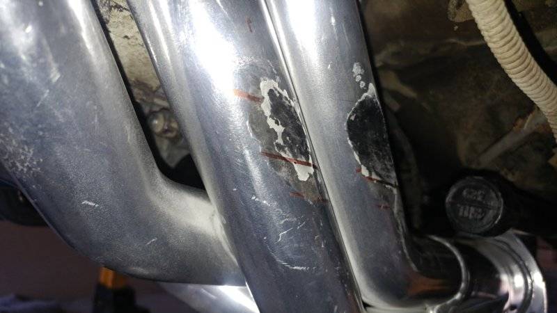

        Torsion bar goes in now but not enough clearance, .010 piece of paper will not slide between.
        I'm done for the day, almost got something done.
        The drivers side header is so beat up it's pathetic! Stay tuned, still have the passenger side Torsion bar to install.

                  How much clearance do I need?
                  I don't want to be hearing it hit the torsion bar when I'm driving it, probably not good for the torsion bar either.
                  1/8th would be pushing it, 3/16th sounds better.
                  Poly loc motor mounts, new stock trans mount.
                    That should be enough.
                    Used MAP gas, made the process much faster. Thanks for suggesting that.
                    Hit it with some ceramic exhaust paint, because I have it and it can't hurt.
                    Torque strap if it makes contact during operation.
