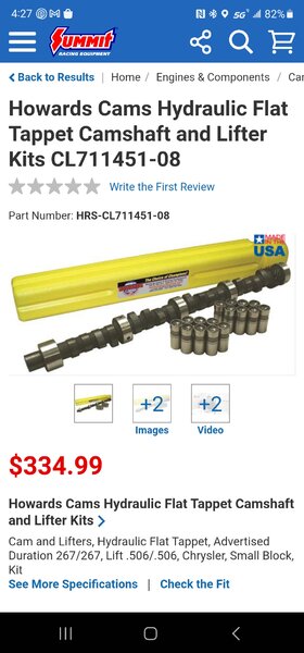

I will never order from them ever. My last order they threw all my Stuff I ordered into a big box with no packaging bubble wrap or anything. It was so bad my yukon dura grip had bounced around so much in the box that it was sticking out of its box. I was super pissed. Summit has always been fantastic. Also with that howards cam with that 508 lift will my stock rockers be ok with that high of lift?

I had heard Howard's is a decent cam company.
I saved some money ordering a Howard's cam and lifters from Jeg's instead of Summit recently. Be sure to check both for pricing if you start down that road. Er, or not, based on more recent posts. LOL.
I just realized that is the same exact cam in your post that I have for my engine. Not installed yet. They had a long lead date to get it too, in the end it was here in 3 weeks drop shipped from Howard's. No fuss no muss.
Just ordered the howards camshaft. They had one sitting on their shelf. Now ordering everything else for replacing broken stuff. I went with a Mancini timing gear set also. Decided to go ahead and get a high flow water pump as well since everything is apart.

Any one have any videos of the Howard cam I bought. I can't find a video on what this cam sounds lIke.
Actually I recant my previous recommendation. Use this one instead.
That way, you can run the Comp 901 spring which is cheap and a drop in. Same basic cam with less lift. Call Howards directly. I bet they have it available quicker than what Summit says.
