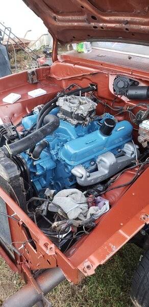

My 360 build
Watch out on your bolts going into the front of that block when you put your brackets on and tighten down your water pump.
I bought a motor one time that the guy had cranked down a water pump bolt that was to long and bent the cylinder wall and then the Piston stuck.

Yes between a 1/8 to a 1/4 inch. I think he was using the bolt that goes thru the alternator brackets on a no bracket hole. Idk but he screwed it up real good.
Damn you making me nervous. I'm sure im ok tho because none of mine had any hard or tight spots going in. And I cranked it over since I put it together and didn't feel anything.

Good idea to use a piece of wire or similar to measure depth and match bolt. Will do that swapping my LA to Mag water pump after being apart for a while.
Yea that's exactly what I did lol. I got a little worried reading the post about that. So I took my bolt out and took a coat hanger wire and carefully pushed it thru till I felt it make contact then marked it and compared it to my bolt. Im good I got over a half inch. I bought a bolt kit and it came with the four long bolts all the same length instead of the 2 long and 2 longer ones like came out. They seem to be fine and fit really well and look good too. I tried to clean up my old bolts to save some money but I thought iv spent all this time and money why not spend another 60 bucks and have good new matching hardware? I'm extremely happy with the results and im glad I did.
