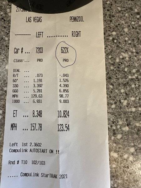

Finally got the car out for the first time and ran within 2/100 of what I thought it would. Should pick up 2-3/10’s at our home track once it opens.
1/27/24, 11:45am
The Strip at Las Vegas Motor Speedway
10.82 @ 123.54
(I’ll edit the post with full weather conditions when I get home)
1973 Duster
All steel and glass except for a street weight fiberglass hood
3200# estimated. I’ll update once we weigh the car
408 LA based stroker 12.5:1 CR
Icon forged flat tops
Molnar crank and rods
OTB cnc ported Trick Flow heads
OTB Trick Flow intake
Comp Cams billet solid roller 258/264 @ .050 and .660 lift
Harland Sharp 1.5 roller rockers
Hedman Hustler 1 7/8” with 3.5” collector race headers
Full 3” exhaust with Dynomax Ultra Flo mufflers
Thumper Carbs 850 based (flows 977ish) billet 4150
TF727 with Cope RMVB
PTC 8” 5800 stall
9” with aluminum dropout, Strange lightened billet spool with 4.30 pro gear
Calvert split mono leaf and adjustable shocks
Caltracs
Hoosier 29x10.50w sticks
Renegade 112 plus. Plan on testing with VP110 in a few weeks.
Video of a bye run. You can actually hear the car in this one since there isn’t a car with open headers next to me…. lol

I know there’s more left but not many guys switch from off road racing to drag racing and build a car in less than a year. Yet alone drive 12 hours and run 10’s first time out. Congratulations my friend. Great job.
