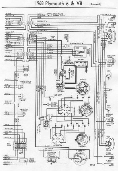

Here is a 68 schematic for engine bay/front
Do these schematics appear factory?
OK so now we know why 68 doesn't have a wire on 'P'.
Yes that does look like a factory diagram. I dont think I can blow it up clear enough to read it. I'll try.

They're not factory diagrams. That's why it says Plymouth at the top. Its from some sort of book or series of books with various makes of cars.

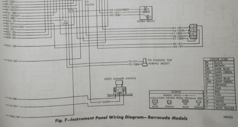

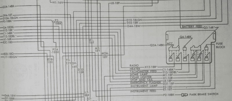

Top of p.112
Bottom of 112
P.113 Top to bottom

I dunno if there is a way to see those images full size.
I'll break 'em up.
Can retake during daylight this afternoon if needed.
Top of p.112
Bottom of 112
P.113 Top to bottom

Steve, Those are from my 1968 Plymouth Service Manual.
I can e-mail you th scans I got from the BOG. Alan really.
They're in pdf format, one pdf per page each. But not sure the scan quality is any higher.
