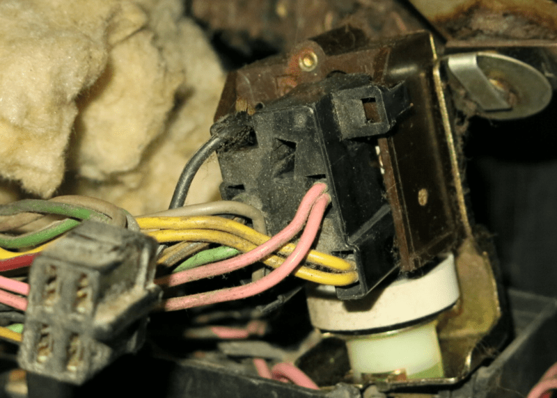

Damaged but original 67 Headlight connector.

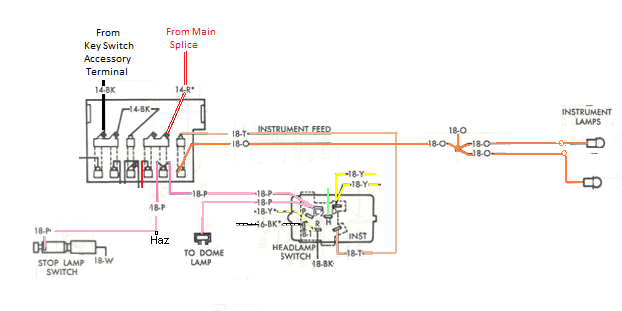

Here's one of my cheat sheets
So it looks to me like
B1 gets power from main splice. 16 awg Black with white tracer. (L1 on the 68 diagram)
P is not used
B2 gets power from a fuse thats always hot. 18 awg Pink (L8 on 68). Same terminal is used as junction for power to dome light(s) (Junction relocated in 68)
D is Dome light return (ground side). Terminal with two Yellow 18 ga wires is junction in the wire between the door jamb switches. Close any switch to ground and the circuit is complete. (M2 & M2A in '68, prob the same function)
Instr is power out to the instrument illumination fuse. 18 awg Tan (E1 in 68)
R is power to parking lights. 16 awg Yellow with black? tracer to front, 18 ga black? to rear. (L7 & L17 in 68, Color changed)
H is power to Headlight Hi/low switch. Green (L2 in '68)
So the dome light wiring junctions are different in '68, the front parking light wire color changes, and the body wiring connector changes from 6 to 8 cavities. Bulkhead connector as you prob know is rearrenged in '68.

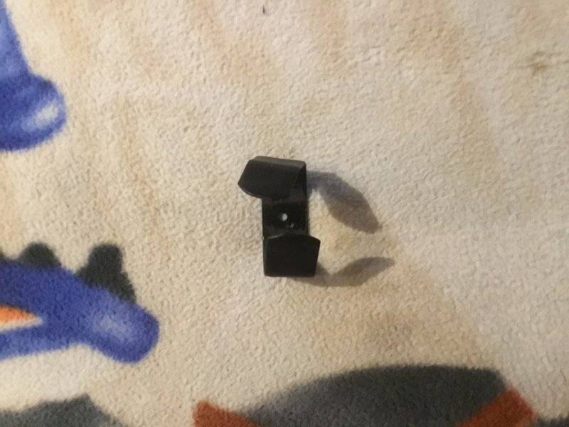

What holds these 'bullet' terminals in the multi-connector?
I don't see a barb.

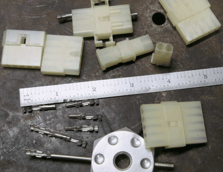

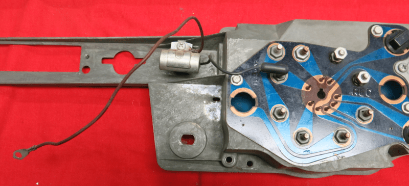

I happen to have a handful of molex connectors. The terminals fit on the circuit board pins, but are clearly not the same. They might be the same as used in the steering column connector. I haven't checked that yet...
Did you find a ground wire running from the capacitor to the radio support strut?
This looks like it could be original.
Its not mentioned in the the 'how to remove the instrument panel' but the panel isn't coming out until one end or the other is removed.:BangHead:
Nothing holding these round terminals in panel connector. Wire goes through the slot and pulled. Terminal bottoms, its diameter captures. If people could or would sort and straighten/align the wire, the black connector could be backed away leaving terminals on the posts. If several wires should come out through the slots, you have to know which/where they go back again.
So I THINK I discovered a difference. Between nb&fb. In Matt's headlight connector pic, you can see the yellow wire with tracer in R cavity. This identifies it as 67 only. 68 up didnt use the yellow with black tracer. See in Matt's pic there are 2 pink wires doubled up in B2 cavity? That(I believe) shows that it is for a notchback, as they had the dome lamp. Fast backs did not. They had a "rear pillar" lamp on each side. I found a headlight connector in my tickle trunk that was from 67(yellow/tracer wire) see pic. It does not have doubled up pink wires from B2. Only a single pink.....:drama:

Steve, It really does matter where the interior/courtesy lamps are one in the roof, 2 in the rear pillars, or 2 in the foot wells of vert. They all are connected to the same courtesy lamp circuit. On and off with door jamb switches and headlamp switch rotation.

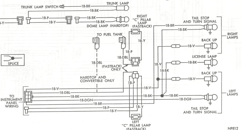

By the looks of schematic, the rear pillar lights are "fed" from #2 cavity (18-BK), at bottom of schematic where it says "To Body wiring"
You can see in the schematic you posted, at the bottom they forgot to label the 6 pin connector.
