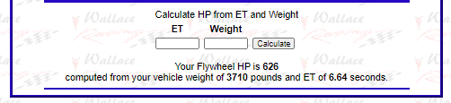

Wallace calculator shows 626 HP at 6.64 101 MPH at 3710 lbs.
101 at 3710 shows 594 when i plug it in on Wallace. MPH is how horsepower is calculated. ET isnt much if any of a factor
As an example my old car went 110 at 3350 pounds, wasnt even set up for 1/8 racing. Using this same calculator, that shows 693 horsepower. My car, at that time, actually made 640. Nowhere remotely close to almost 700
So i think the 626 horsepower is ULTRA optimistic.
Probably more like 560, maybe 570.
throwing big numbers around sounds good, but MPH tells the real tale.
This is what I used.

you are using ET, not MPH. Doubt anybody on this board would disagree MPH WAY more accurate a tool to use for horsepower. Nobody uses ET.
Not picking on your results bro. Just saying( from experience) what i know to be true. Your truck runs great.
