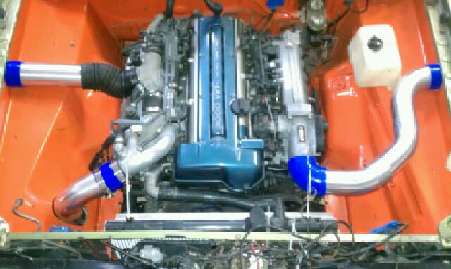

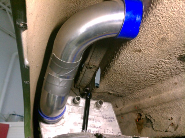

Tim's mint IC fabbing today.

Details continue. No glory for Timmy fabbing upper rad brackets, welding shifter linkages, custom dipstick tubes, and battery boxes. It's these details that we have to finish before we can attempt to start the car. We have 1 month and that really means only about 40 actual man hours left to button things up. I know that sounds like plenty of time but there still a few things on the list. I know we, (Tim and Dave), are both tired but it's getting to look like a real car and hopefully it run well.

I will say that there are probably 100 easier and cheaper MOPAR only ways to produce 320 RWHP! ;) But what makes the Supra engine nice to play with is the fact that you CAN make 750 horsepower to the bags with a 2JZGTE if you run a big single turbocharger and an aftermarket ECU. This swap DOES require some fabrication in the sense that you need subframe connectors and crossmember to support a center bearing as the drive shaft will be too long and reach critical speed just when the speeds start to get fun. On a 108" WB car not as much of a worry but the extra few inches put us at 58" U joint to U Joint.
Overall though it fits like a dream even with Mopar rear steering and there is no problem getting to bits and pieces under the hood or under the car.
We tried our best to build it with a Harbor Freight band saw and a MIG welder and other than getting the aluminum charge air tubes welded by a Tig welder.

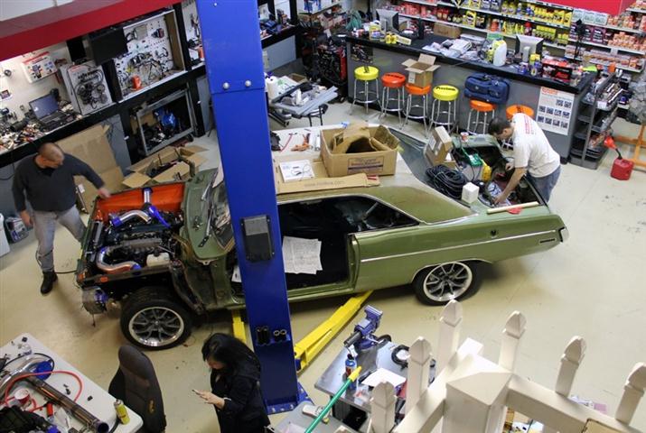

It's alive! It's heading to paint this weekend and with the doors and clip off we really can't get it on the freeway just yet. Lots of updates....I will be posting as soon as I get a break.

Long nights and a couple of all nighters and the Scrapyard Scamp heads to paint.
