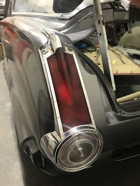

This what I did with my car today, body gaskets from Detroit muscle.
