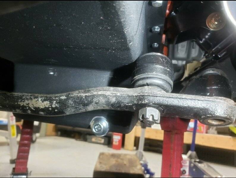

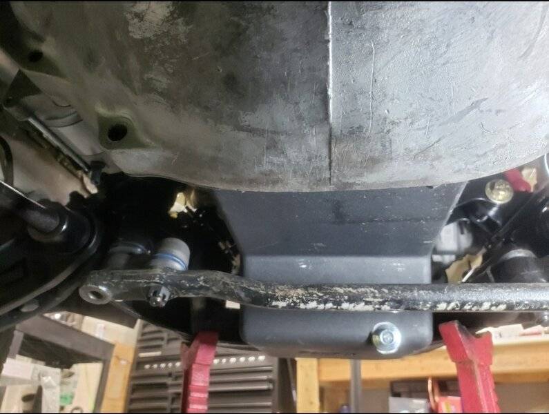

The one unknown for me is if the sump location on the Holley pan has issues with the centerlink when the motor is in the stock location. @Dantra did a 6.4 into his Dart with the Holley pan and his motor is like 5/8" forward and I don't remember him having issues. But since the pan was designed by Holley and they move the motor forward, they might not have left room for the centerlink if the motor is back from their location.

The 5/8 forward didn't save or destroy me, as far as steering clearance.. the only advantage was firewall to 6.4 intake clearance. In return, my header to Borgeson box clearance went mmbye bye. I switched to 73 up steering components, which cured 99.9 of all steering clearance issues. I still just barely touch at full right. I plan to add a stop after some suspension and brake upgrades, if needed. For now, I'm just conscious of it.
SOmething to note.. I did try setting the motor down low, for wiper motor clearance. If it were raised a little, the steering might squeak by. Plus spool mounts might set it a little different.
How was clearance between the back of the sump and the side of the centerlink? Did Holley leave room for their pan to be used in the stock engine location?
The more I think about it, seems like others have used the Holley pan without their mounts. So probably not an issue.

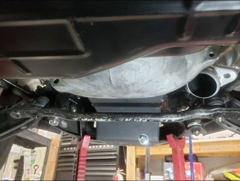

We did this swap in my son's 73 Scamp. TTI spool mounts and headers. Milodon pan as well. Like I stated earlier, at the very end of steering travel, drag link makes slight contact with pan. If you plan to auto-cross or drift, then it's a concern. When using the factory tray/gasket, make sure you RTV the four corners.
Ok will do. I'll go with the Milodon pan. Makes sense on the drag link making contact. Just a town ane highway car so should be fine. Thanks for the info, that helps a lot!

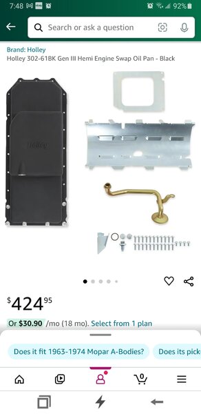

Got to be kidding me. I just ordered everything including dipstick and it was $650.
Cancel.. You over payed. Given the choice, I'd still go with the Holley. I bump th pan at full right.. Just like the Milodon does. I prefer the cast.
Even though I have TTi motor mounts?
That picture of the idler hitting the pan is without tie rods and the steering stops are on the LBJ. So that might be further than the idler actually travels. Have you checked again with the steering completely assembled?
Barely taps with everything hooked up. I don't ever turn full lock anyway. But when I do a disc upgrade, I'll set the stops
Well I got the Milodon and the Holley side by side. Sump area is identical as well as the rest of the geometry appears to e identical. Due to price point and build I'm going with the Holley!
