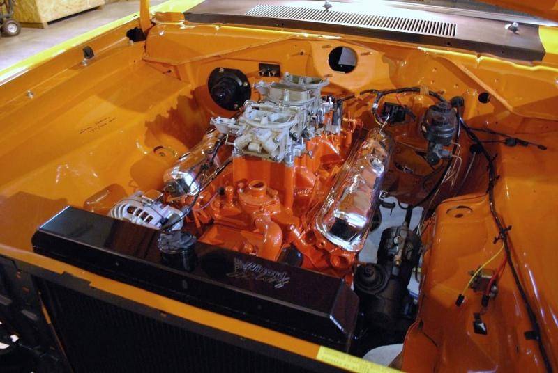

Ok I tried a search and couldn't come up with much.
So let me see some pics or hear your opinions.
I'm not opening the which cools better debate, this is all about aesthetics.
This is for my 67 Barracuda.
All stock-ish under the hood and I'm concerned the champion radiator will now not look right.
I will attach a recent pic of my current under the hood situation.
What do you guys and gals think?

nope, not painting it - I like the look - in fact last time I had mine out I cleaned and polished it.. it matches the heads and a few other things. I think it really depends on the look you want - blacked out gives you a more original look where natural aluminum gives a custom look... the differences between mine and ir3333's image are obvious - yet they appear to be essentially the same car.. his looks to be a restored 340 Duster, mine isn't... it's all in what you want.
I have a Griffin Perfect Fit radiator in my 69 Barracuda. It has a very stock look to it. I painted it black with Eastwood's Radiator Paint, and it looks good.
Here are a couple pics of the raw aluminum radiator installed and then with it painted with Eastwood black paint. It all depends on the look your after.
