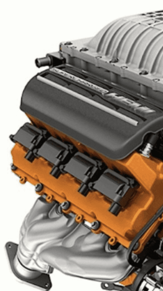

i run the stock coils. 2 sets of them even. do yall even look at the pictures i posted? lol
Yes. But what we are suggesting is to mount them like this.......
If you are having RFI problems (and it’s likely you are with how yours are mounted) this will solve it.

Got it. FYI the coils proximity to sensors and or sensor harness is really the problem. They’re proximity to each other isn’t necessarily a problem if the high tension leads are routed neatly and crossfiring doesn’t happen.
