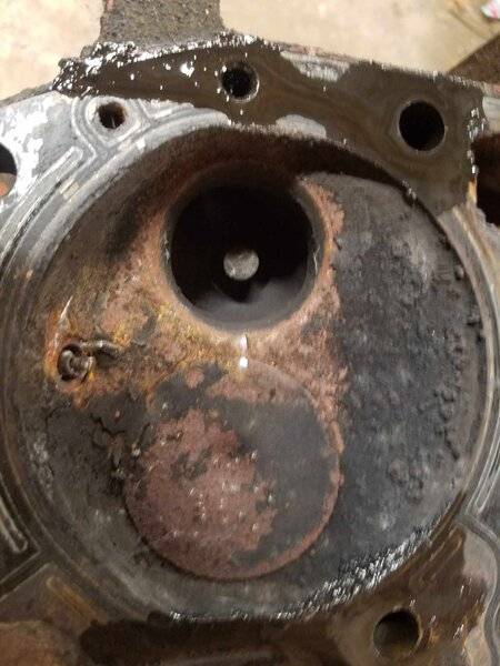

What's your thoughts about the 906 heads? I thought they were brought up in here somewhere, but as luck would have it, I couldn't find . Heck, maybe I'm wrong. I uploaded the 906 head I took off the 383. I think you'll look in disbelief. Block's not cracked, heads not cracked, Valve didn't go complete through the piston.

Musta been idling. lol Yeah, if they check ok.....but again, they'll require a lot of $$$$ to get them right. Guides, hardened seats, new valves......obviously. lol You'll just have to weigh it all out.
well, there's your problem-- you have a BFH in your engine!
all kidding aside, RRR is on the money. i'd sit down and run the numbers to see how much dosh it would be to make those heads work for what you want/need vs what a new aluminum set would run ya.
