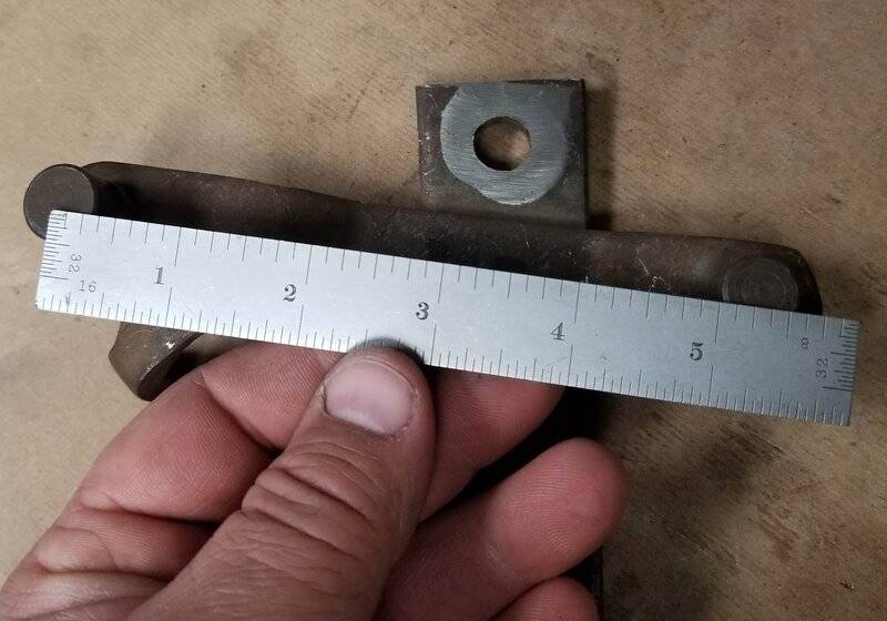

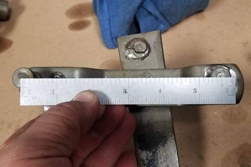

Read this and you'll be able to fix your issues. I did this to many A-bodies having your same problem and they shifted like butter even at a complete stop. Also if you installed a Diaphragm clutch you must remove the over center spring on the pedal assembly. Been playing and street racing these cars since the 70's. There are 2 different clutch pedal assemblies used. With a borg and beck three finger pressure plate you must use the heavier spring red which calls for the side brace used on earlier assemblies. If not start doing squats to strengthen your legs.
https://www.motortrend.com/how-to/mopp-1012-four-speed-a-body-clutch-pedal-adjustment/
The red spring style is 6 inch the blue spring style is 5 1/4.

I painted the springs red and blue for reference. They were not painted on these sets . But the side brace would usually identify the 6 inch style.

More then likely you have the wrong pedal assembly for your pressure plate. Change the pin spread from 5 1/4 to 6 inch. You will get more release of the pressure plate. This was changed due to the the complaint of pedal being harder to push with the 6 inch spread. This can be done by welding 3/4 inch extension on yours. It will shift easier. Especially into reverse and first
Not to throw a wrench into this scenario, but I have run across 3 different pin spreads on the A-body pedals. My Demon has the 5.25" spread, and I have no problem power shifting at 6,000 RPM with a mild SB. Even has the larger 10.9" clutch disc.
What years cars used 5-5/8”?
Honestly, I haven't figured it out clearly yet. Most of the "core" pedal assemblies I buy, do not come with specifics as to what engine/trans/model year combo they came out of originally.
Dan, Power shifting was never the problem for me with either. I found the 6 " always shifted into reverse and other gears easier when the car wasn't moving. But I never tried this with your upgraded synchronizers
What I did see was when the diaphragm style pressure plate is used with the over center spring in place and you pull a gear while holding the throttle flat to the floor. " Flat Shifting" The pressure plate will not re-engage until you let off the throttle and the RPM's come down. Just ran into this with the Barracuda for Todd I built that trans for that needed the second gear that was popping out of gear.
I myself only ever had 5 1/4 and 6" pin spread . I never saw any other spreads but that doesn't mean they were never produced.
