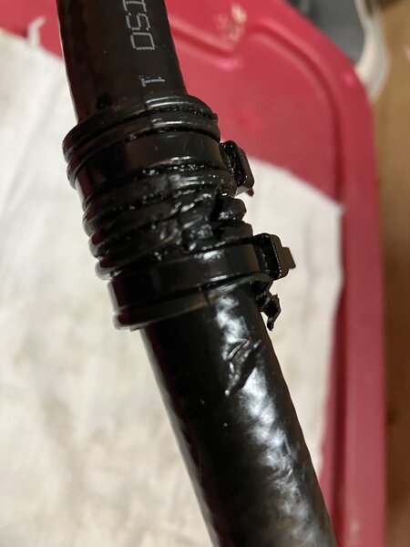

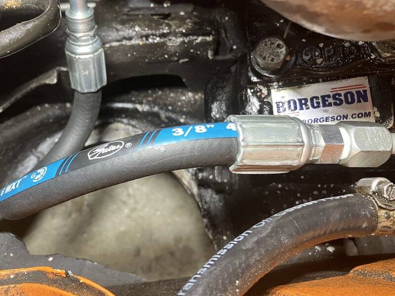

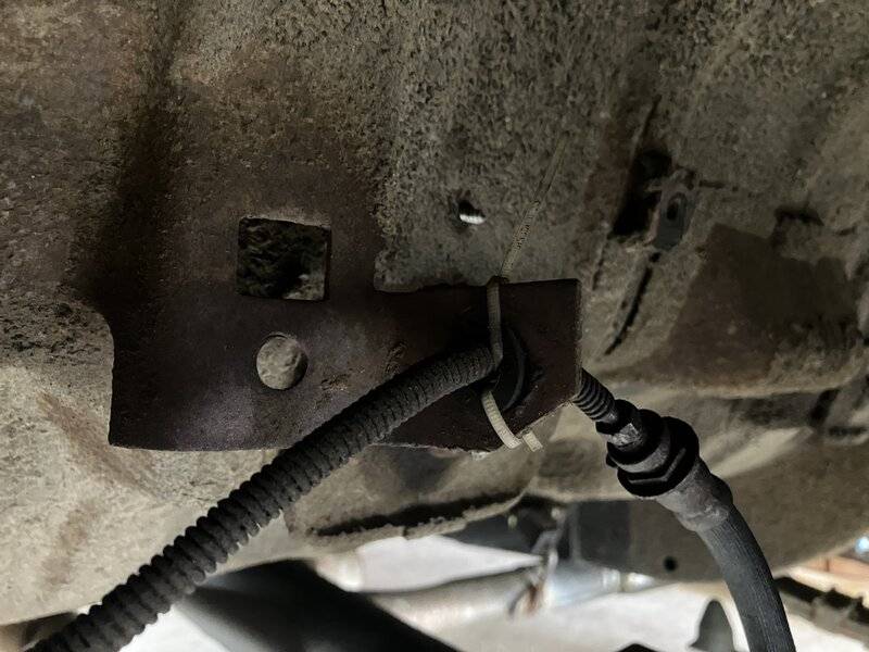

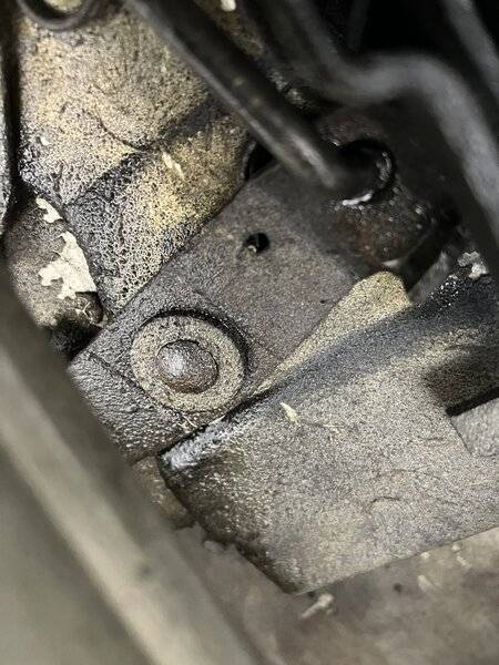

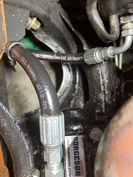

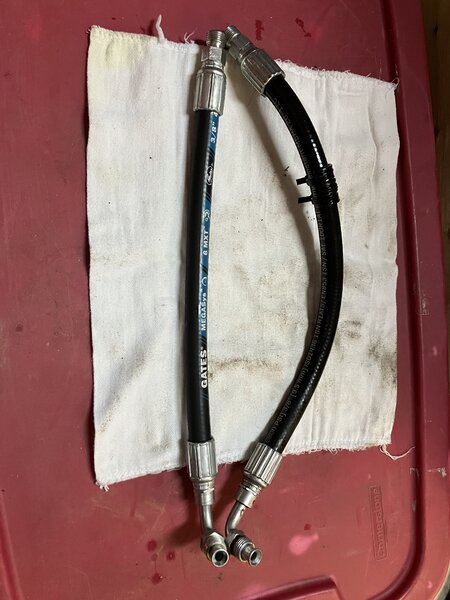

The “crud” on the hood in post 139 was from a hole in my PS line. It was jammed in there pretty good. I should have known better.
I was up in Forks last week and had Whiteheads make me a shorter one.-like in 5 minutes!
That fits much better!

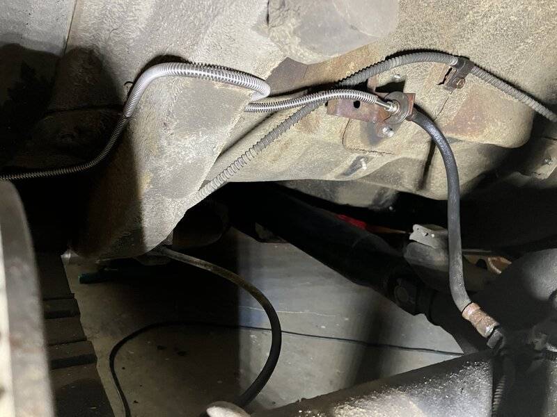

My front to back brake line looks like some sort of fossil!
I had one rust out and pop open on my first A body a couple dozen years ago. So this one has been on my mind for awhile.
The only rough spot was the clip had been missing. The line itself was in pretty good shape.

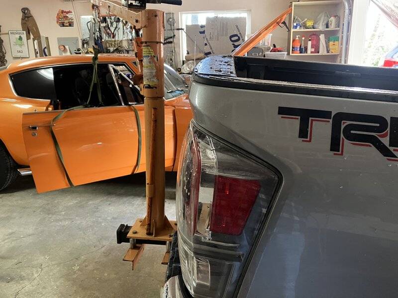

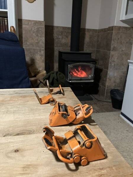

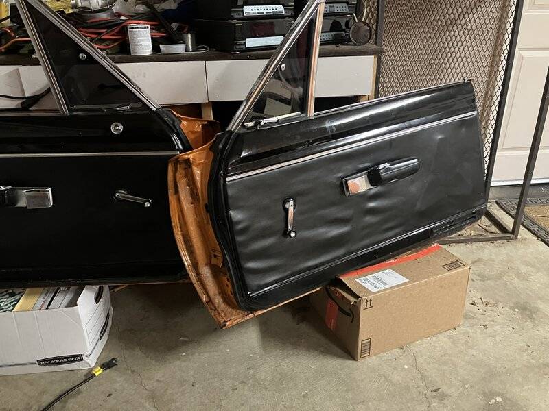

My door hinges sag, groan or creek when I open the doors , and rattle going down the road. So I sent them in to get fixed. Here is what I had going on for panels:
The PO made these but I remember that symbol from my old Dart. Glad to have them gone really!

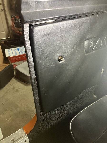

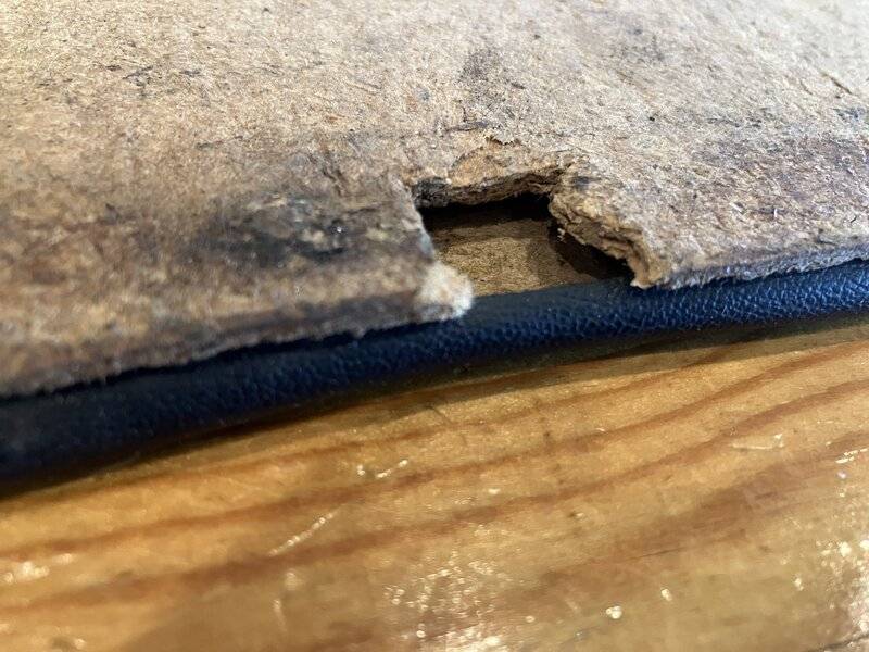

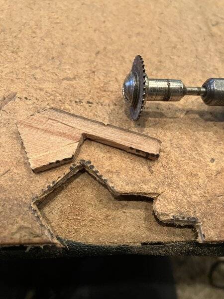

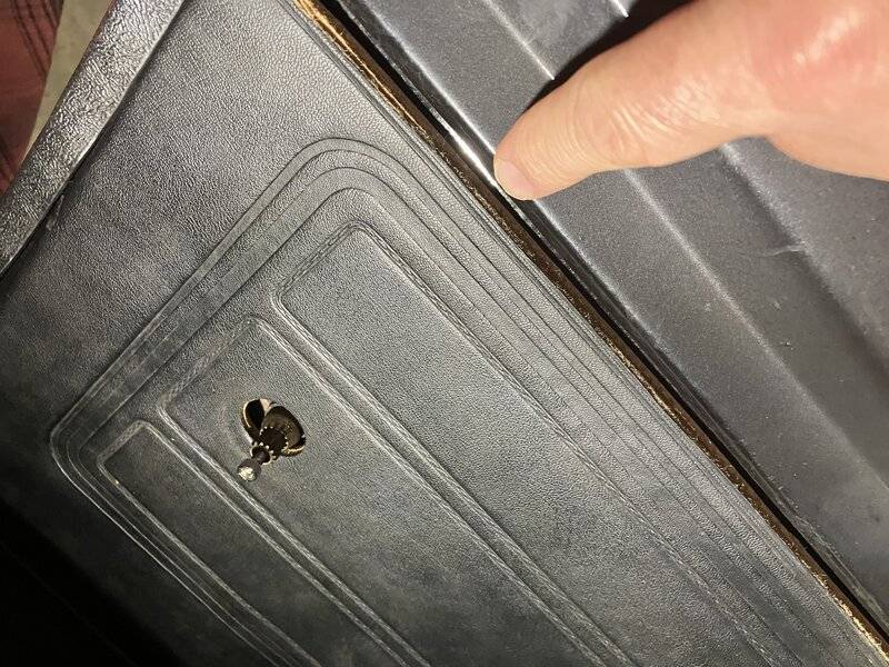

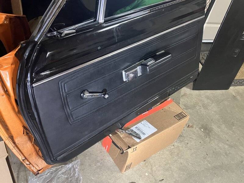

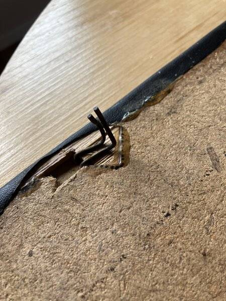

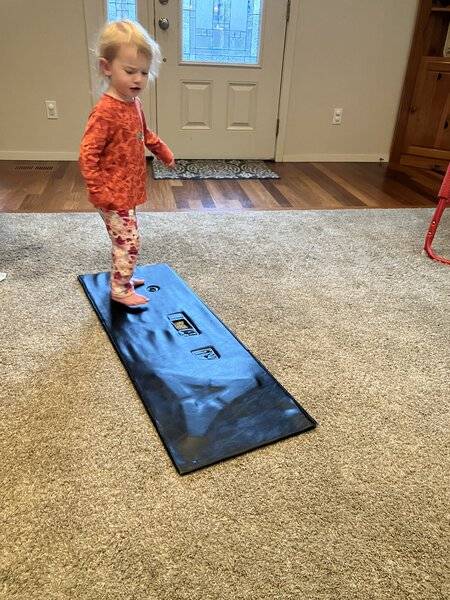

The “new to me” cards where from another 68 barracuda that apparently received a nice new set. These required a little TLC as the vinyl had come loose along the bottom and a few clip holes had been damaged.

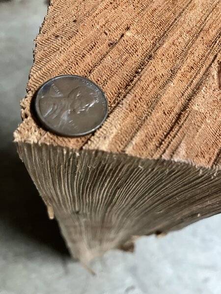

I used a sliver from western red cedar block. Tight grain, splits thin, real tough, and rot resistant. Then reconstructed the damaged card around the clip hole. I did 4 of these and used a heat gun to straighten the vinyl in a couple spots.

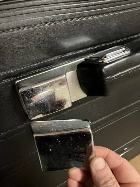

Test fit and they look pretty good! But where is the chrome in the back? Funny that I never noticed. I just purchased a set from another member in NY and they are on the way!

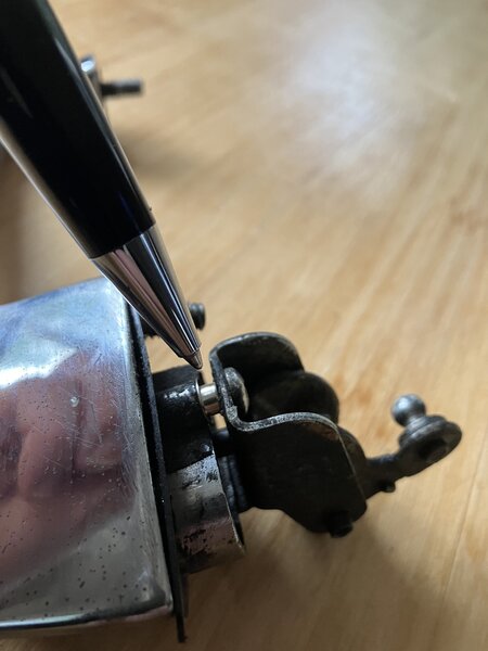

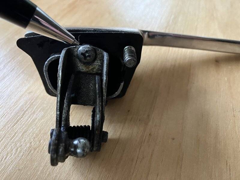

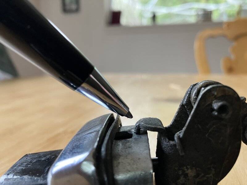

Before I can close the doors back up, there was the issue with the locks…well that they’ve never worked! Key matches the ignition just not engage.
Passenger side needed cleaned and a clip on the lever control. The button on the door handle was coming loose on the driver’s side.
The metal is worn around the mounting screw. It needs replaced but I stuck a “spacer” in there and it seems pretty robust. Everything works now!

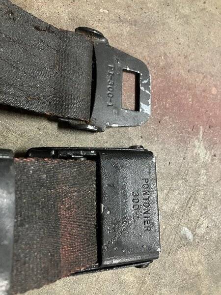

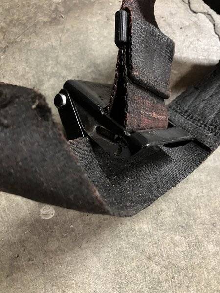

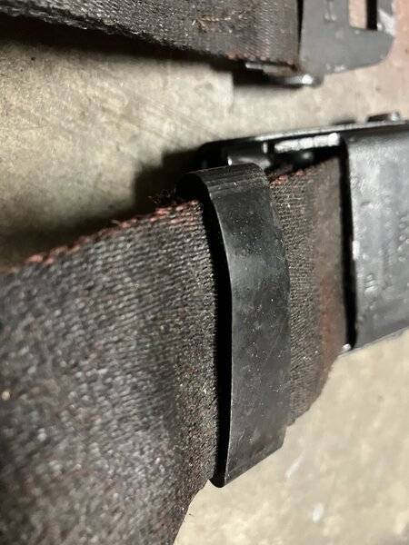

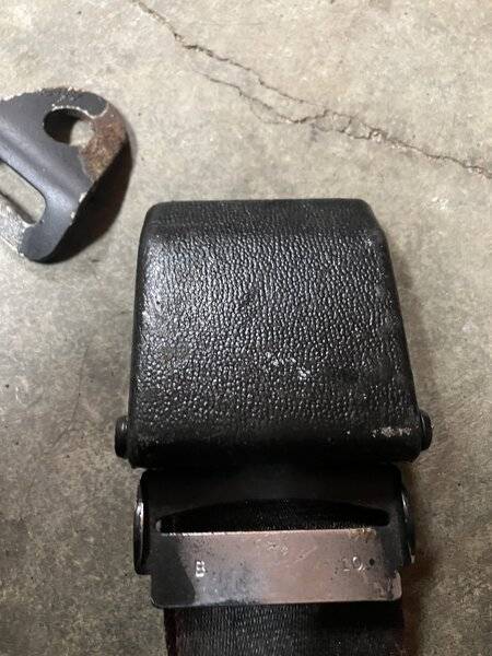

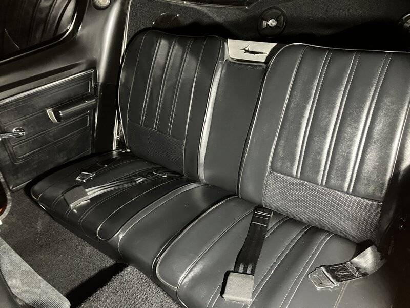

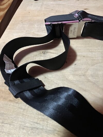

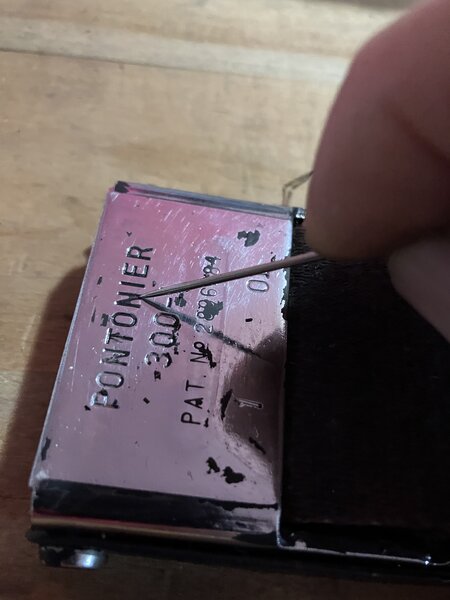

So the interior has never looked better since I’ve known the car so I took some time to straighten out the original seat belts in the back.
Maroon painted black and living in a box of parts.

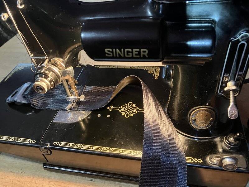

Re webbed and cleaned up!

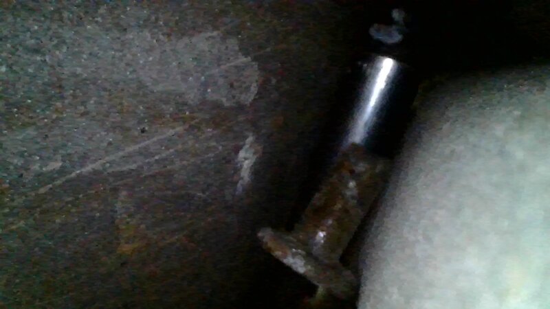

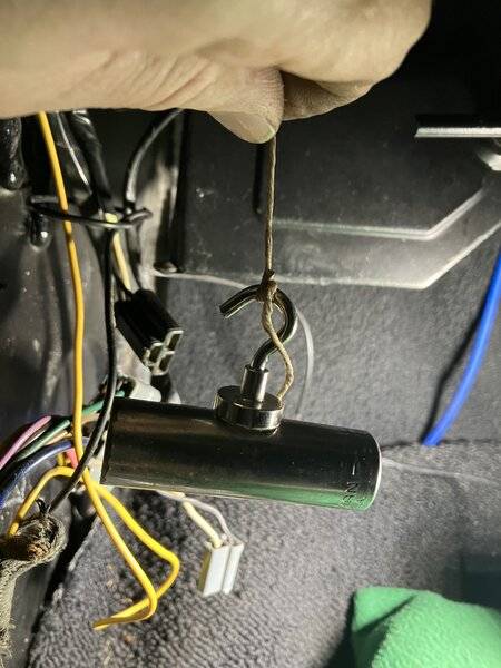

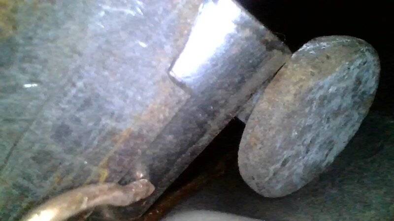

I don’t know what it’s called but the area where the door hinges bolt to. I dropped a socket down in there. I spent a couple hours trying to get it out. First I had to extract a large stud that was also in there.
I learned that a magnet, tied to a string that was threaded down from the top and dragged back up was the way to get ‘em out.
found these on the fridge! the hook unscrews so I could use that for weight to get the string down to the bottom, then screw the magnet back on and drag it back up. Voila!

Nice to see an old sewing machine like that getting some use! My first ex-wife had a similar one that I had to move from house to house to house probably 8 times... Never once did it actually get used though...
Very nice. Love the color and tinted windows. Like some of the others have said. It’s your car, build it whatever way you like. When mine is done it will have several incorrect things on it. Most notably the 67 inner fender wells, oops forgot to tell the body shop to cut those stinking nuts off of there! Oh well. Maybe someday I’ll fix it and maybe I won’t. I plan to enjoy mine regardless of what others think. You should too.
Thanks, my heirs will be the most perturbed that I didn’t at least start with an M code though:)
Mine has been dragged around too but they run and work great! Working with old machines is like using a piece of art and makes the results (or miles driven) more enjoyable I think.

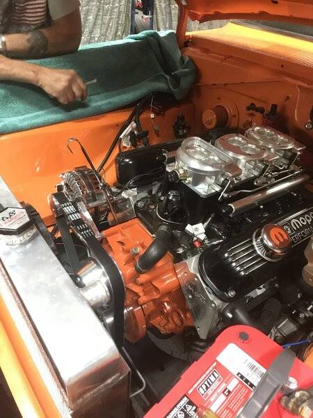

Took it out a couple times that we had sunshine in March. I had a rear shock fail and acquired an electrical gremlin mystery to unravel. I think that I found the new issue (broken ground on my aftermarket voltage meter and a burnt brush assembly in my alternator). Taking the opportunity to do some overdue housecleaning in here since it’s all open. I’ve removed 6 deadhead wires, inspected the universal or welded splice (looks great) updated the wire to the alternator, cleaned up all three bulkhead connections. Cleaned up the fuse box, and found a pinched wire harness. I removed the crushed sections of a couple wires but they seemed ok. I left the others alone fearing that I would add more resistance splicing them. There was a short in the horn circuit too that I’m not sure I’ve rectified yet. We’ll see when I get the last of this back together and powered back up.
Just got back in from taking it up the Wynoochee, back down the Wishkaw, and back up the Chehalis with my daughter. She slept most of the way. It sounds and feels great! I often thought that circuit would be a lot of fun in orange car but must admit it’s better with one that’s much tighter w/ bigger brakes! Save for the farm truck using both lanes at one point, it was still a nice ride.
Replaced the horn relay and the air pump after the aforementioned short burned both up and the horn workED great. Then when I bumped the turn signal lever it honked again …. Grrr
At least I know precisely where that short is now but that’s the second switch I’ve put in there in as many years…. Ground wire off of the relay for now. I wanted to get some miles on it while the sun was shining.

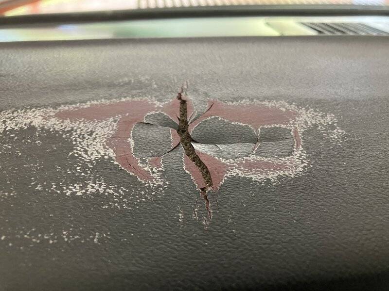

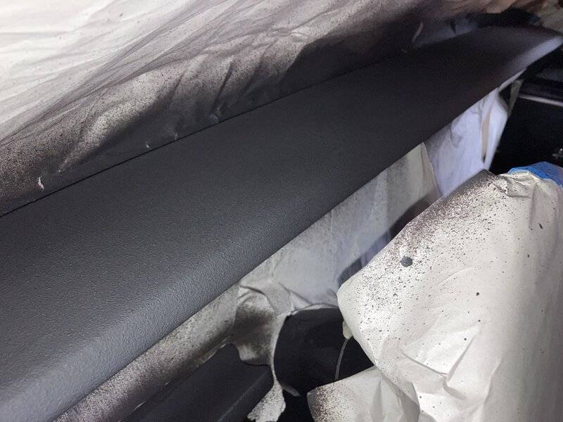

Finally, while buttoning the dash back up I had an epiphany for my crummy dash pad:
Painted original burgundy pad with bulls eye that predates me. I sanded the high spots off, filled the cracks with shoe goo, masked up the interior and shot it all down with undercoat!
Some of these repairs are “temporary” right? It beats staring at that spot I’ve had since 2011 anymore.
What d’ya think?
