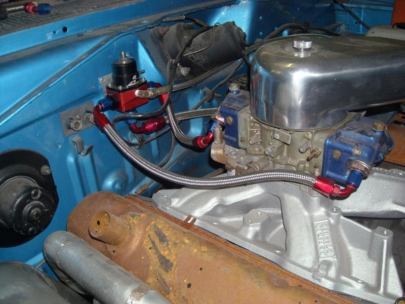

You might reconsider the placement of this regulator, if you plan on running at NHRA drag strip. As I recall, they do not want regulators and such mounted on firewall, incase of transmission part failure, that could cut or damage lines and cause a fire.
I am running off memory, you might double check.
You are probably right. But, I bet they would ***** about no cage before the regulator:tongue:. I thought it would be safer running it there and outside the driverside frame rail instead of the inside of the passenger rail where it could be destroyed there too since it is right beside the bellhousing??
There is only one NHRA track here in Baytown, Tx.. I no longer support that track since the owner change. I run 3 of the smaller independent 1/8 mile tracks. Who knows??
Looking good buddy. The NHRA/IHRA wont let you put the regulator there either. Turbo cars are notoriously hard on transmissions, and you don't need to lose the whole car to a nasty fire when that happens. Just my two cents, those rules are there for a reason. The fuel line and regulator need to be on the outside of the frame rails till they pass the flywheel.
I think there is something in the rule book about the brake line being near the bellhousing also....
Looking good buddy. The fuel line and regulator need to be on the outside of the frame rails till they pass the flywheel.
I am not ?ing you!
But my Falcon had the 1/2" Aluminum fuel line attached to the inside of the rail all the way to the regulator that was mounted to the right front rollbar over the suspension. Most every car that I have seen the line run along the inside of the rail. Now it was only the main line cause the inlet lines to the carb were on the normal right side then to the carb. Of course I did have a CSI trans shield around the glide and a JW bellhousing.
The tech guys never said anything but they did pop me for the wrong size allthread that held the batteries down!! I had to change it to 3/8" instead of 5/16".
Again, this is a streetcar that will see little track time. I frequent more of the street meets and car shows locally. I do however go to several of the local 1/8th mile tracks and they seem to be a bit more lax on tech'n cars.
My brother-inlaw can get me some "Inconel" tubing that I can route the fuel line through if that might help.
Thats a whole other issue. All the brakeline run right there beside the bellhousing on the inside of the framerail too!
