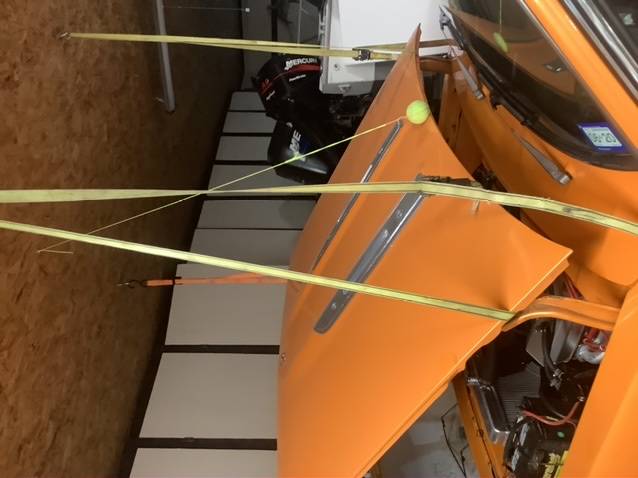

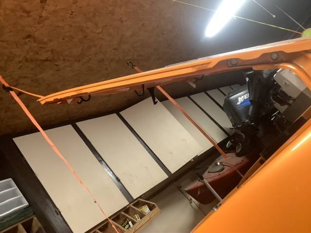

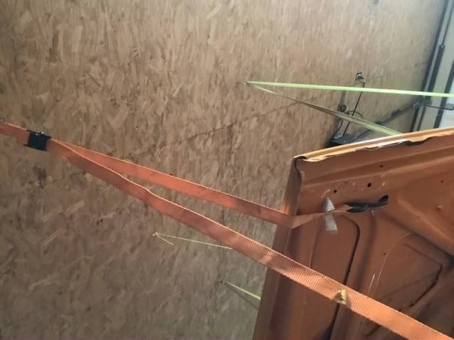

At the end I could pull those last two straps to center the hood too. I would use more substantial hooks in the ceiling next time. They were fine for the weight straight down but not for pulling hard at an angle. I hate solo hood installation!
