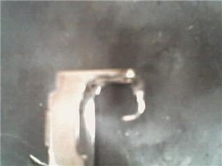

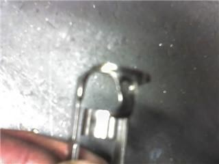

Here's one that somebody really cut down to get the shifting where they wanted it. There's barely any weight left...LOL!! I should be able to do the governor swap this weekend and also change the speedo gears. I'll take plenty of pics and post them. Again, if you're smart, you'll do all this (Or have it done) when you get the tranny overhauled and it won't cost a dime extra. I would have done all this during overhaul but there's no way to know where the car will shift until you actually drive it with the new tranny.
