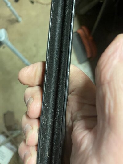

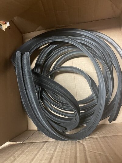

And it’s a mini Christmas for me in September- I received my window channel and divider bar channel - both carefully cut to length

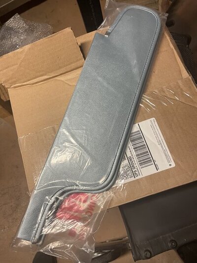

Plus my new sunvisors which will compliment my new arms I bought from Layson’s a few weeks ago arrived tiday as well.
Yes, they are early A convertible sunvisors. Why convertible sunvisors you ask? Because they are so much wider than the regular sunvisors and when secured into the convertible rear view mirror bracket, will cover virtually all the way across the top of the windshield. I wish they were taller when blocking the sun but us beggars can’t be choosey. They are manufactured by REM and must be ordered through one of their sales reps. Here’s an interesting tidbit of info - i ordered them from Deutchman Automotive who is my Mopar Nationals neighbor every year. He said I was the 3rd person to order convertible sunvisore in the last month! The thing was None were for a convertible! All were for a hardtop or in my case a sedan

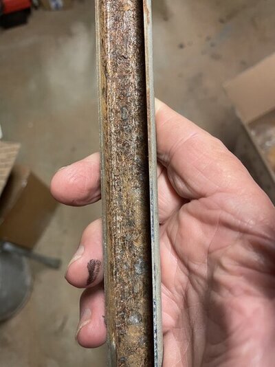

i decided to start on the 2 little left and right tailgate window channels to see how things were going to go before starting on the doors. I couldn’t even budge the old channel out of the retainers. I ended up using a flat tip screwdriver snd my little ballpeen to remove the channel, which is actually made of rubber with a flocked area where the glass rides. It’s amazing that the rusty channel retainer will hold the channel so securely! After thinking about it, I guess the glass seal at the top didn’t keep a lot of water out and got between the channel and retainer. This one was the best of the 4 that I have:

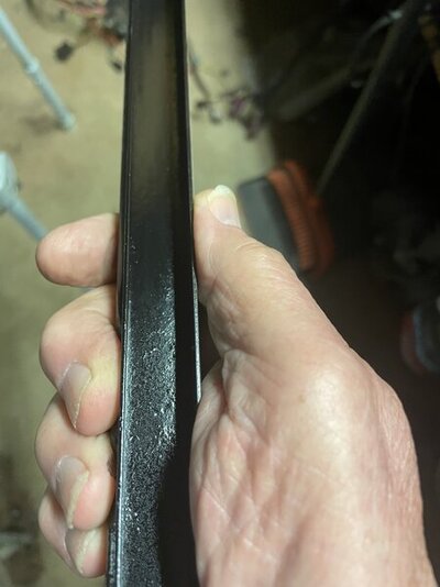

I cleaned it with a wire brush in a drill which cleaned it up somewhat. A cutoff wheel in my air tool did a much better job! I then painted the inside of the 2 that turned out the best
then it was cut the channel to length and install them in the retainers. They are definitely not as eady as they look to install. They are now ready to install in the tailgate

I tackled the driver’s door window channel today, which went better than the passenger door. I ordered the vent window division bar channel when I ordered the rest of the channel. That went fairly easy for both vent windows. Like the main window channel, I’d recommend having a couple of glass sticks on hand to seat both style channels in their appropriate frames. Next is install the door glass. I seem to recall it needed to come out at the same time as the vent window assrmbly. Time to research the shop manual.

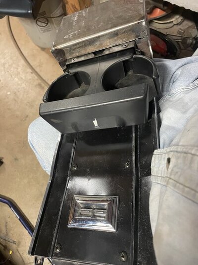

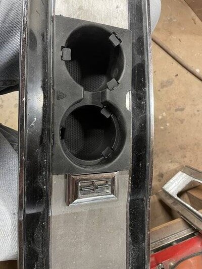

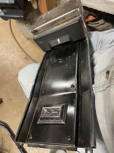

I found a pullout cupholder in an old Ram center armrest I had. The more I thought about it, the more thought I could probably fabricate some kind of bracket to mount it to the console top plate. Because i had hacked a big hole in the top for that other cupholder, to repair it I found a suitable size sheet of aluminum at Tractor Supply. After cutting it to size I bolted it in place and started on fabricaing a bracket for the pullout cupholder. It took several attempts before I was satisfied with how it all looked. I also had to move the power window switch as well.
Once it’s finished (prime and paint the top), i think it’ll be much better looking (and when closed) out of the way than the old cupholder that was flat on the console top.
The cover on top hides the hardware used to mount the cupholder (it’s top mounted) and has enough room for a toggle swith or two or a warning light if needed.

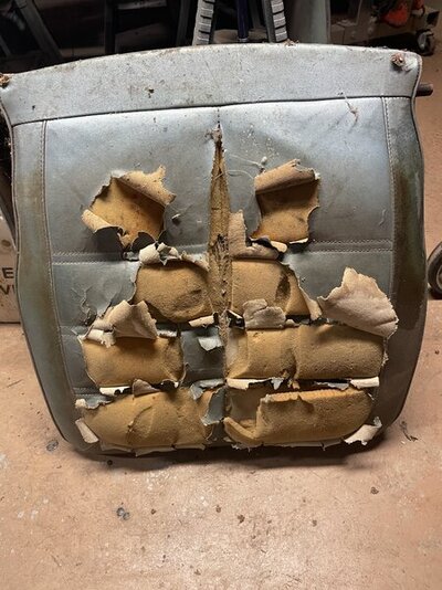

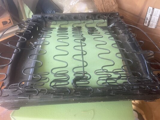

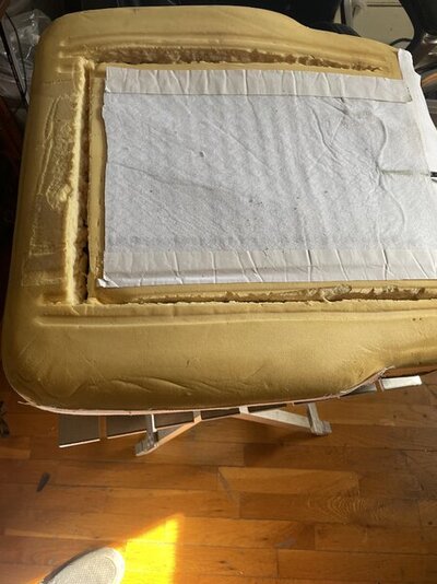

Although I’m not doing anything out where the car is due to the unheated garage, I thought why not work upstairs on a major component - the front bucket seats! I had saved a set of 66 Dart buckets and since the 66-67 seat frames are the same for A and B Bodies, these would be just fine for my 66 Barracuda upholstery.
After stripping the old nasty upholstery and foam from the driver’s seat, I cleaned the frame. It was in great condition.

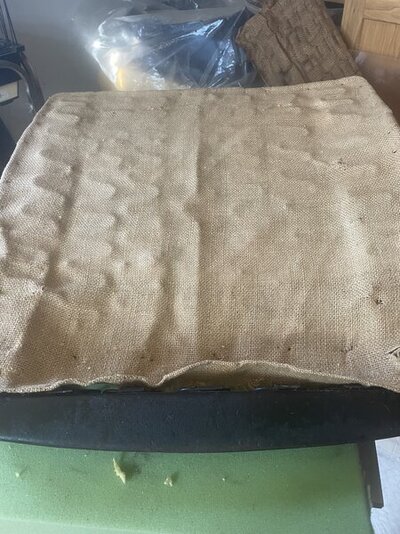

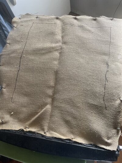

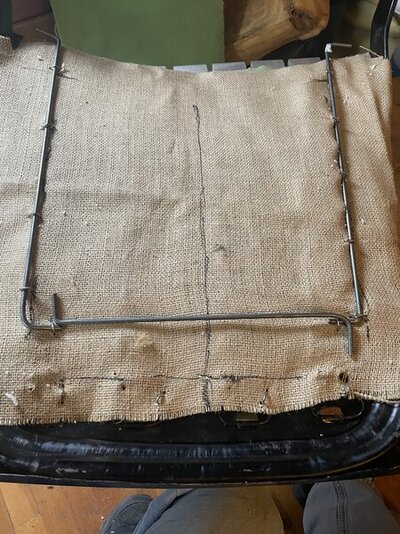

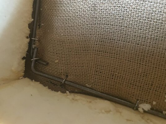

Then cut new burlap to size and hog ringed it in place every 3 inches or so to the springs
Next measure the location on the upholstery for the listings - if any (the 66 Barracuda’s seat cushion has 3 listings - 2 sides and one in the front) and mark the burlap for the listing wires. I had to order a roll of felt that’s to be hog ringed around the spring perimeter over where the burlap was hog ringed. This is to protect the upholstery.
I also marked the foam and cut slits in the foam for access to the listing wires that will be hog ringed to the burlap.

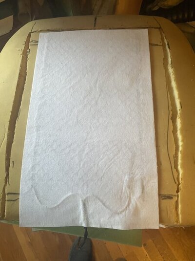

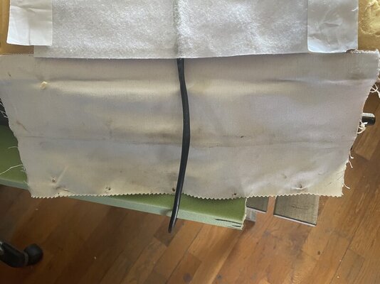

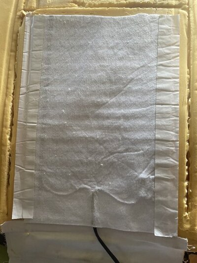

That white sheet with the black pigtail is for a heated seat. Yes, gonna have heated seats should I drive my baby on a cold morning. I also cut to size and glued the muslin to all 4 sides of the foam. These will securely hold the foam is place when it’s installed
Then cut new burlap to size and hog ring it in place every 3 inches or so to the springs
Next measure the location on the upholstery for the listings - if any (the 66 Barracuda’s seat cushion has 3 listings - 2 sides and on in the front) and mark the burlap for the listing wires. I had to order a roll of felt that’s to be hog ringed around the spring perimeter over where the burlap was hog ringed. This is to protect the upholstery.

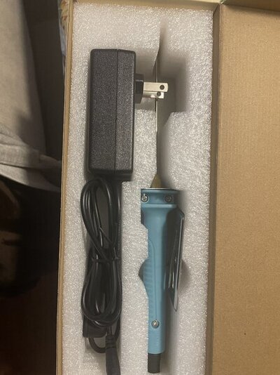

I used a razor knife to make the slits in the foam - not ideal compared to the demonstration done in the Legendary video. So I ordered and received this afternoon an inexpensive foam knife. I will put it to good use on the passenger seat rebuild and driver’s seatback as all 3 foams will need to be slitted for the listings

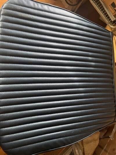

Installed the felt I received around the spring frame perimeter.
Next was to install the foam and hog ring the muslin sheets I previously glued to the foam to the appropriate areas on the frame
Next was to hog ring the 2 side and front listing wire in the upholstery to the wires previously hog ringed to the springs and through the burlap. Then with a lot of grunting, pushing on the foam to get the upholstery over the foam in the corners and down the sides, tugging and pushing at the same time and with some help from my trusty helper (the wife), i was able to get the upholstery on and hog ringed to the frame. I ended up with some wrinkles on the side bolsters. I’ll let it sit in the afternoon sun for a few days and if needed, redo the hog rings on the sides one at a time
Before and After
TO BE CONTINUED

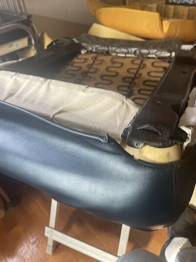

Before and After

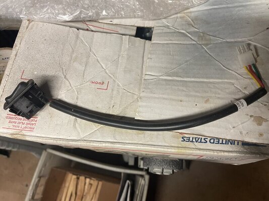

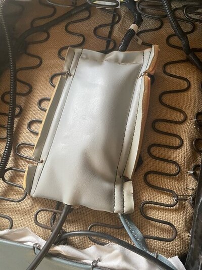

In addition to adding heated seats, for my driving comfort I am adding an aftermarket power lumbar setup to the driver's seat. I installed the pump to the under side of the seat springs
The pump feed at the bottom on the protective bag will be routed to the bladder on the seat back. The wiring harness is pretty simple - a red power wire to the dash harness and a black ground wire. The harness branches off to a momentary switch - one way pumps up the bladder; the other allows it to deflate.
I will mount it on the driver’s side where the for and aft lever and button normally goes. It’s not needed since the seat frame will be installed to a power rack. When it gets warmer all the seat’s tin will get painted to match the seat upholstery - light metallic blue
I am not too impressed with this upholstery foam knife. Once the blade is heated, it does go right through the foam. By using a sawing mothion, it does cut the foam, jthis meyhod doesn’t leave a nice smoith cut unlike the knife Legendary uses. I suppose if I were doing upholstery full time, it would be worth buying one if those expensive knives. For my two seats, i’ll just deal with it

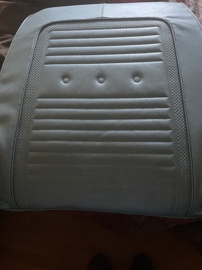

Continued from post # 1019 - So onto the seat back. Prior to starting, i cleaned and painted to pivot arms black. As with the seat base, i started with new burlap hog ringed to the frame
Then the rods weee added
The heating element for the heated seat attached to the foam

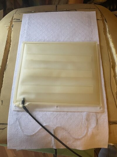

The bladder for the power lumbar was next
Then pull and tug while uttering some choice words during the installation
And finally the seat back ready to install to the seat base. I will comment (again) it’s definitely not as easy as shown in the Legendary video
