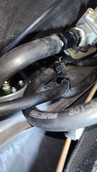

I traced the fuel line from the carb to the rear, no other pump found. Line fed into the left side of the regulator in pic. I crawled deeper under to try and get a better pic. Wish i had a lift.

It wouldn't surprise me if the rubber hose has worn through on the top of the differential housing and is the source of your leak, plus as mentioned by @junkyardhero that fuel pressure regulator is in a terrible place. Whoever did this disaster needs a kick in the head with a steel toed boot, that is nothing more than a slow fuse to a devastating fire. It must be corrected asap. Looks like a good part of your lack of power is solved, keep at it, even if you don't keep the car, the experience and knowledge will serve you well when you decide to buy another one.

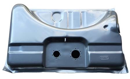

Looks like it might be square sided. It might be a fuel cell, and it might have an in-tank pump.
Assuming the leak is in the lines, you could keep that. Run a short flexible line to a copy hardline, then to a regulator, then filter and to carb. If you must use hose for distance, then something like AN (Army-Navy spec) is the best choice, although expensive and a PIA to work with.
On the other hand, if the only way to solve the leak is to drop the tank, then going stock may be the way to go.

It is looking Like you have an in the tank electric fuel pump, look how it is bolted in instead of the factory lock ring.
Also has the external fuel pressure Regulator mounted on the upper shock rear cross member.
__________
Now the question is do you still have the factory mounted mechanical fuel pump mounted at the passenger front of the engine ?
All those extra gas hoses at the back, is a good place for it to leak.
Then trying to push the gas from the tank with 4 psi coming Out of the rear regulator, with an electric fuel pump up to the engine.
Whoever set that up needs their head examined. Surely not done by a classic car guy that knows mopars.

No pump at front. See fuel line on firewall to side of carb
Nicely done with the fuel line zip tied to the heater hoses.
JMO, that fuel system can use a complete redo from a simplicity and safety approach.
If you lived by me, I'd suggest coming over and take an afternoon to clean it up.
That plate on the tank is on the horizontal plane, correct? That is a sender or a pump as others have mentioned.
